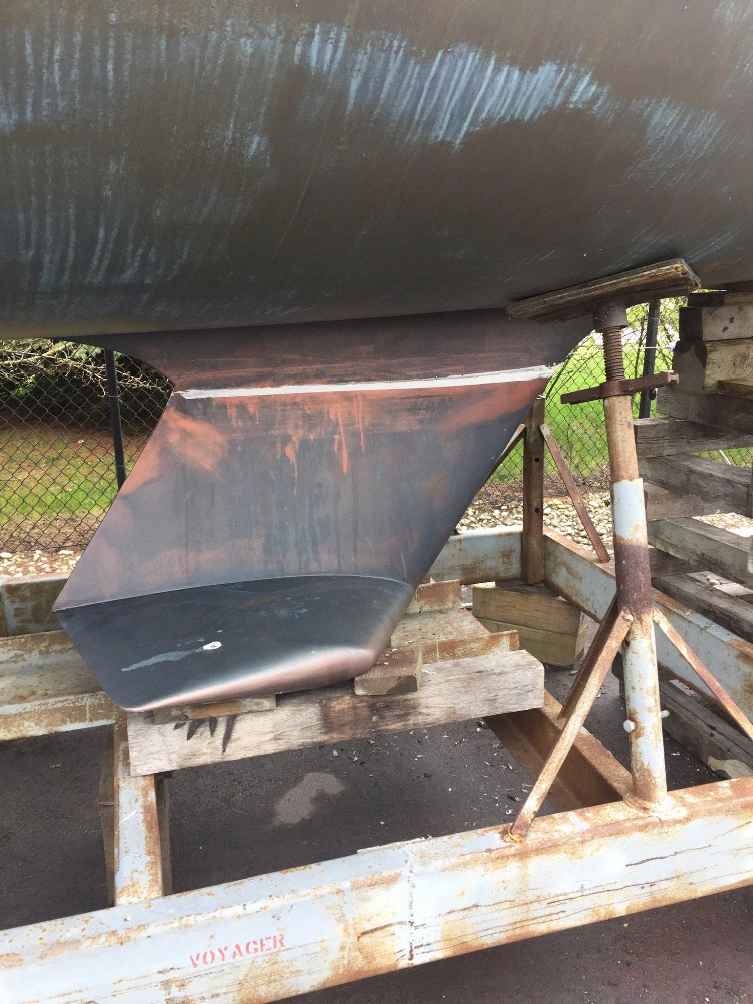

It’s a real thing, but it seems to vary by year and hull. If you see any kind of gap between keel and hull that would be a definite warning sign. Even if you don’t it would probably be prudent to inspect the laminate thickness in the stub. @acarter has a pretty good write-up of how he did that at 322, my winter project

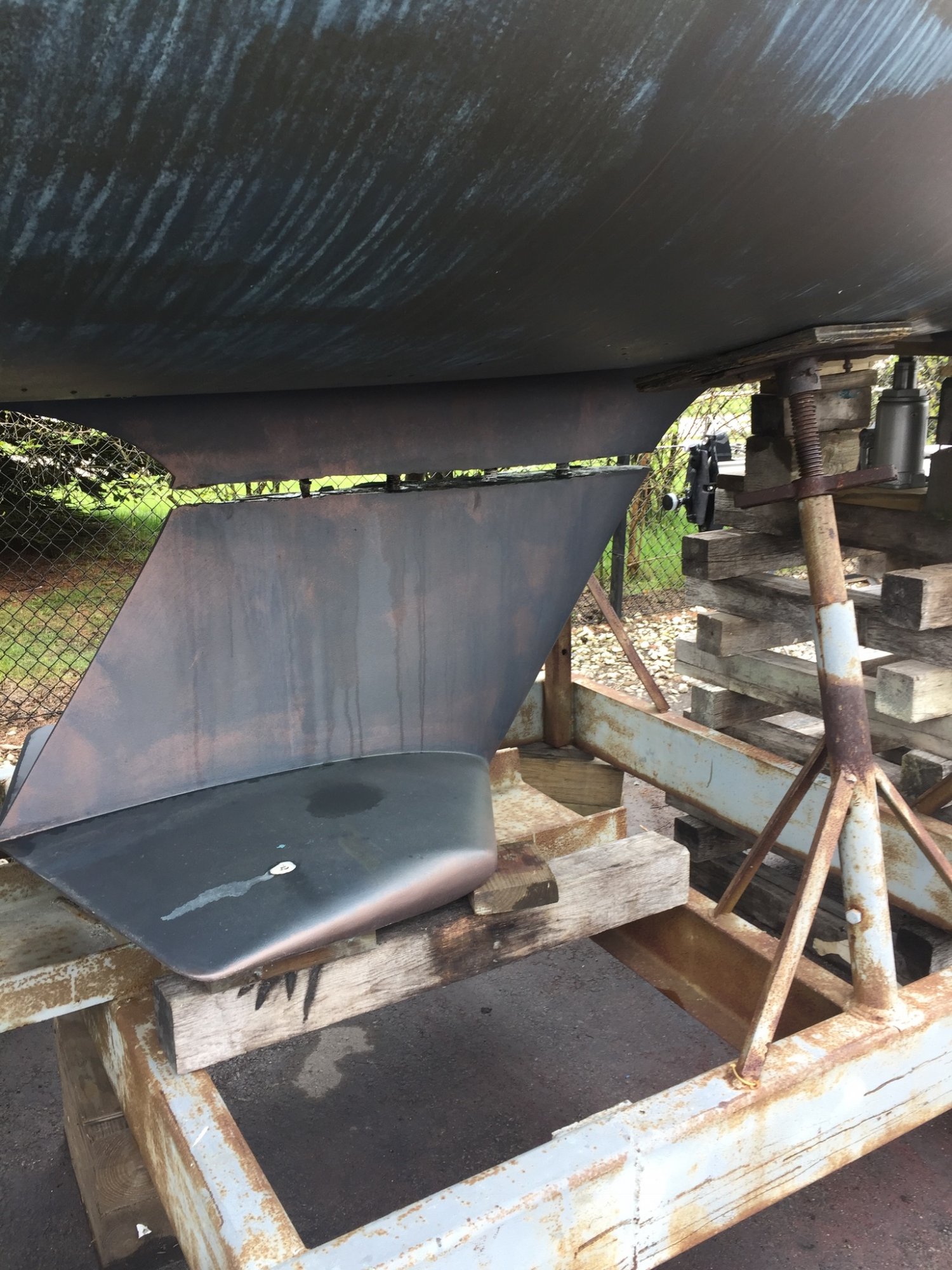

When I bought my oday 302 I had the same concerns. First time I pulled the boat out there was a 1/16 gap all around the keel joint. The bedding completely failed. I ended up taking the mast down, lifting the hull off the keel with jacks, cleaning the old bedding an resealing with 5200. Torqued the keel bolts down. If you are concerned you can always pull the keel to give yourself peace of mind.

If I keep my 322 in retirement ( I do have dreams of a 37-footer of some kind), I will probably drop the keel as @Voyager1 did. That would give good access to inspect the fiberglass thickness and layup in the stub (which I think has been the reason for the keel failure). The theory is that the quality of the boats built towards the end of the receivership period was poor. Checking the bolts and rebedding the keel should give some peace of mind.
