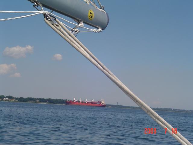

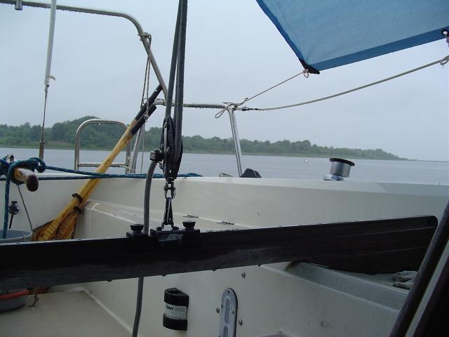

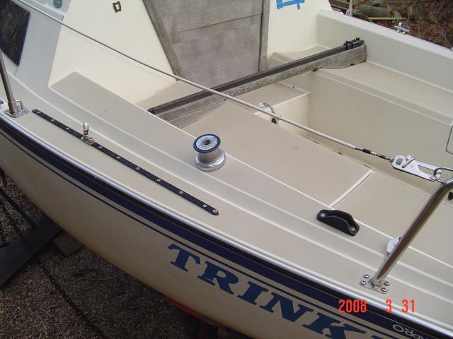

PcAl,
That's the one drawback with travelers. It does prohibit seating room. So what you could do is install a pad eye somewhere in the center of the boat and come off that with your main sheet block&tackle to a mid boom eye strap. For ideas, check out a book called "Sail Power" by Wallace Ross for various sheeting arrangements. It might be in your public library. My boat came through with the main sheet block and tackle coming off a stainless steel triangular plate attached to the back stay and the end of the boom. I hated it and got rid of it by mounting the traveler on a piece of Teak across my seats just in front of the companionway. I have to step over it to get in and out of the cabin, but the sailing performance that I gained from having a traveler was worth it.
