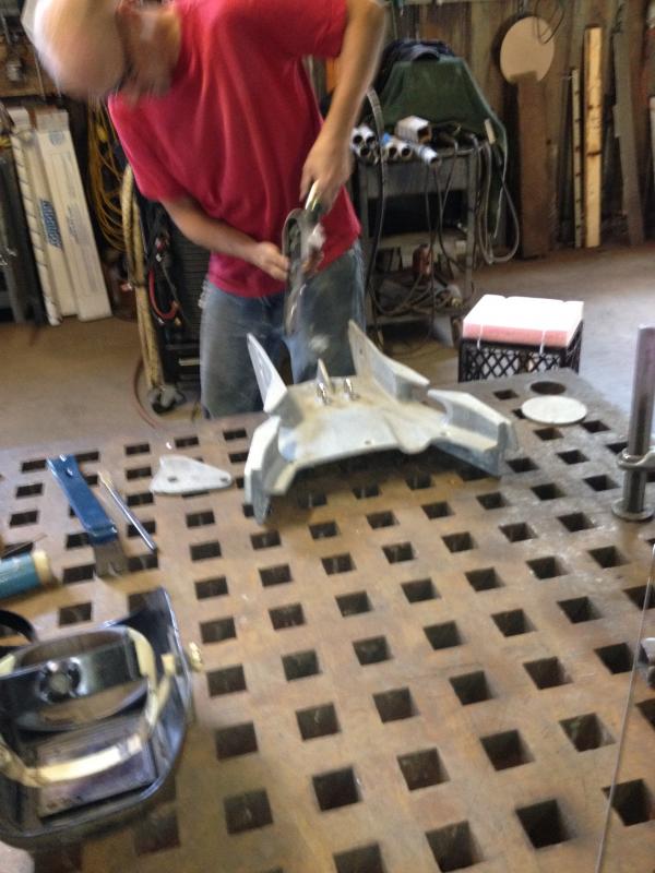

You are in luck. I just removed mine and had it rewelded.
Here is a picture of the wizard that welded up mine. Look familiar? click on the photo to enlarge. Note the middle divider sitting along side.
I suggest you send yours to these guys and let them repair yours. My boat is just outside their shop so they can make sure it fits properly.
Here is there website: http://aggressivemetals.net/
