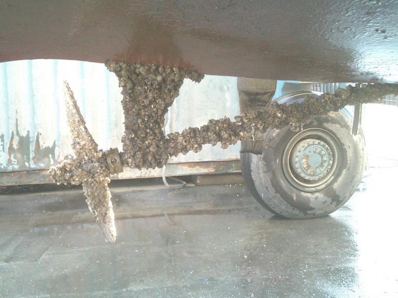

Hauled yesterday (sniff!) so I have all winter to contemplate the problem. Look at the prop. No wonder she was smoking at low RPMs.:eek:
