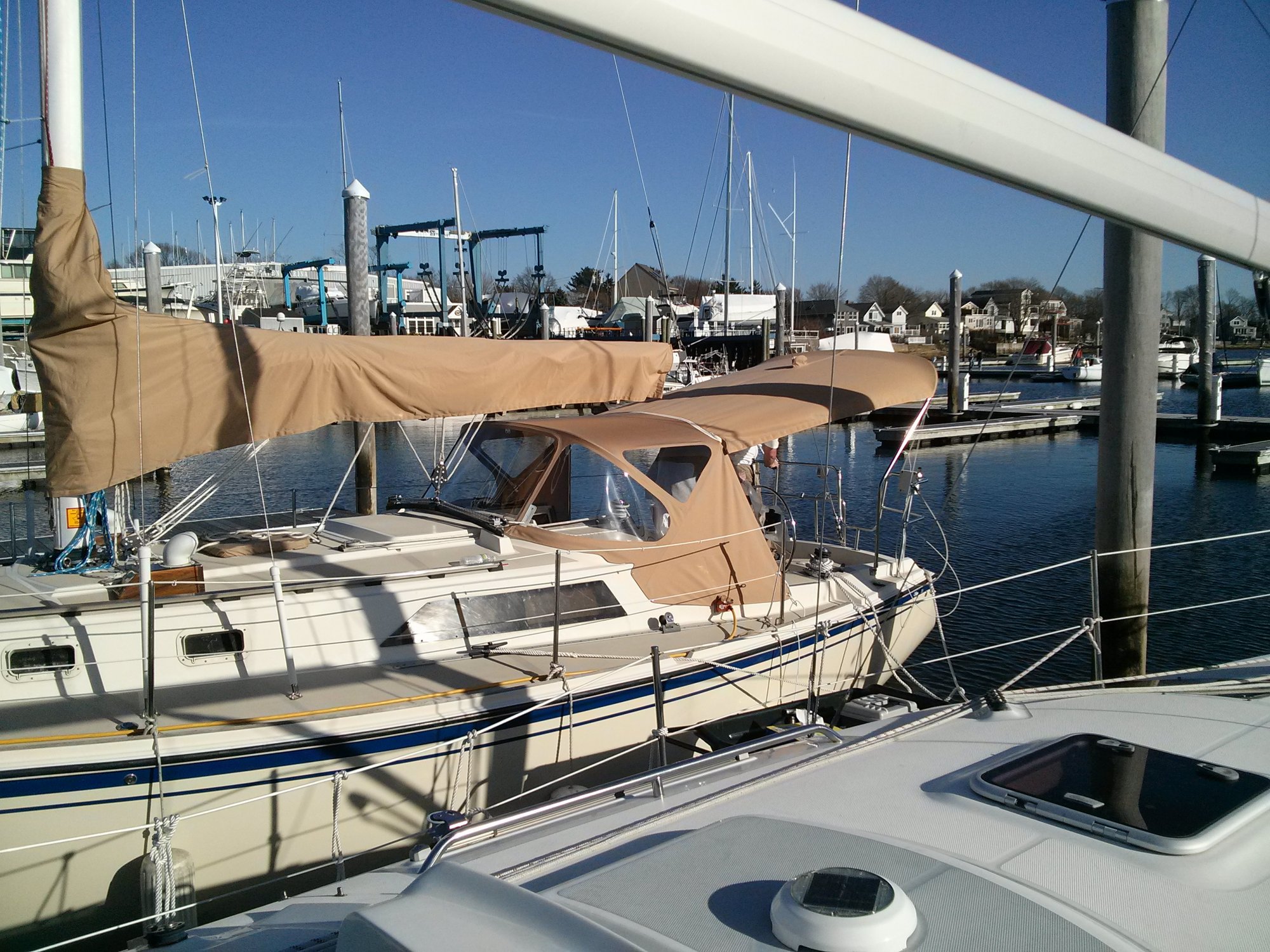

This is mine;
It has been installed for 10 years now. While the dodger is faded, the Bimini looks like new (because I keep it rolled up and covered when not in use). It is on a single support, aft of the backstay. When I want to deploy it, I unroll it, and snap/zipper it to the dodger.

Whew! That is a really nice set up! I'm guessing you had a professional set this up for you. If so can you refer me to them please.
The shop, Mobile Marine Canvas from Harpswell, ME, seems to be out of business. I reached out to them last season to have the Strataglass dodger windows replaced; and received no reply. However, I believe that any experienced canvas maker could replicate it. This is not a DIY project.
The owner carefully measured and patterned the cockpit and cabintop of my boat. He then built a frame for both the dodger and bimini, and built the dodger and bimini to fit. All of this took place over the winter of 2011/2012. In the spring of 2012, he returned to the boat to install, and everything fit beautifully. He took the bimini back with him, however, because he wasn't happy with the fit. I also asked him to install a window in the bimini, so that I could see the mainsail trim when the bimini is deployed. He mailed it back to me after making these adjustments.
