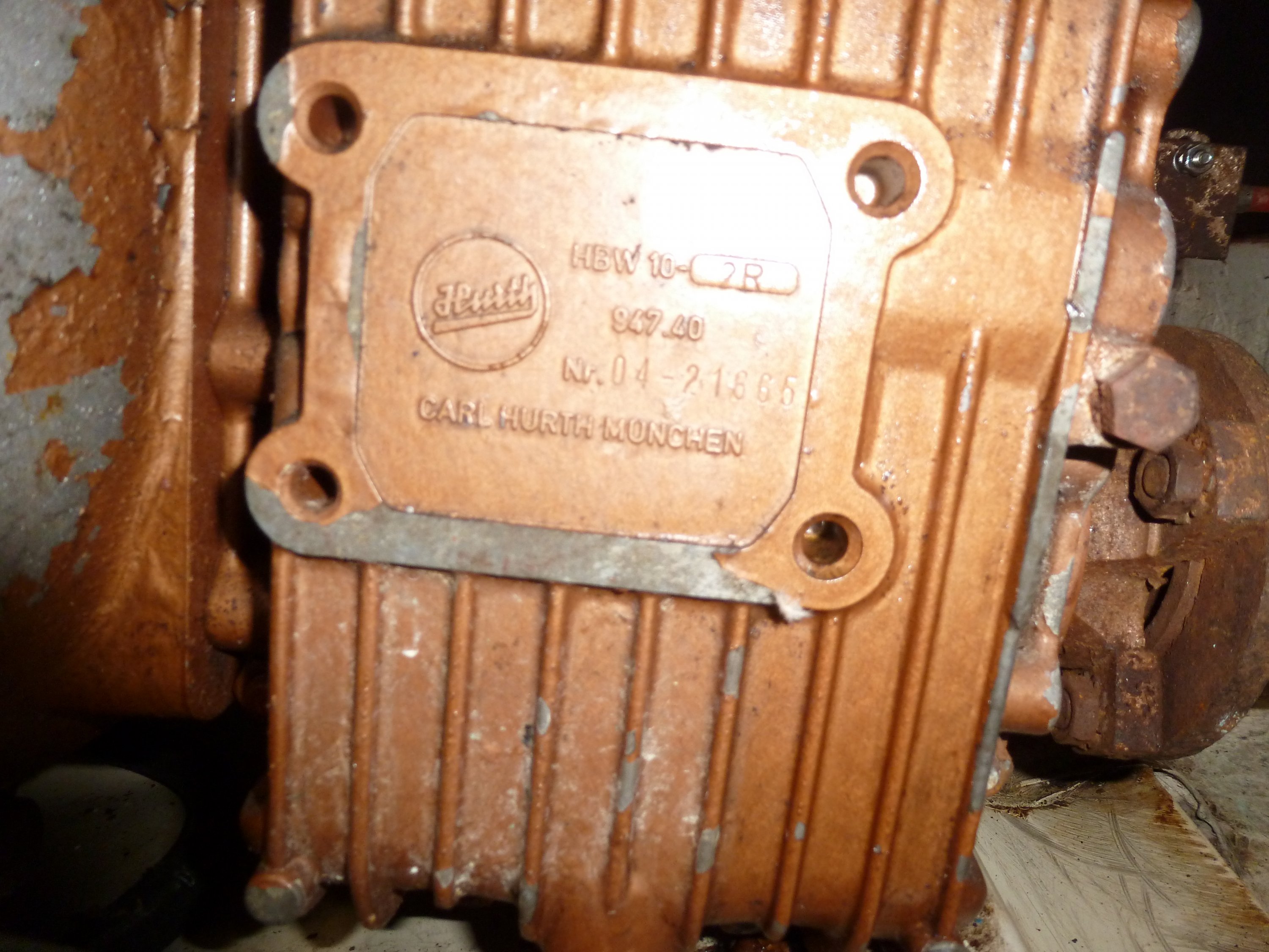

Dang, Karma's transmission is having trouble getting engaged in forward gear. Is slipping as evidenced by no forward power. I can get it fully engaged by shifting into neutral and back into forward and/or slowing to idle then increasing throttle. Prop shaft turns freely, and I've adjusted the shift level to cable to insure a complete throw into gear. Recent fluid changed showed nice red ATF color so no evidence of overheating.
Have I overlooked anything? If not I'm the next step is to remove and replace the transmission. It's a HBW 10-2R, photo of nameplate attached
