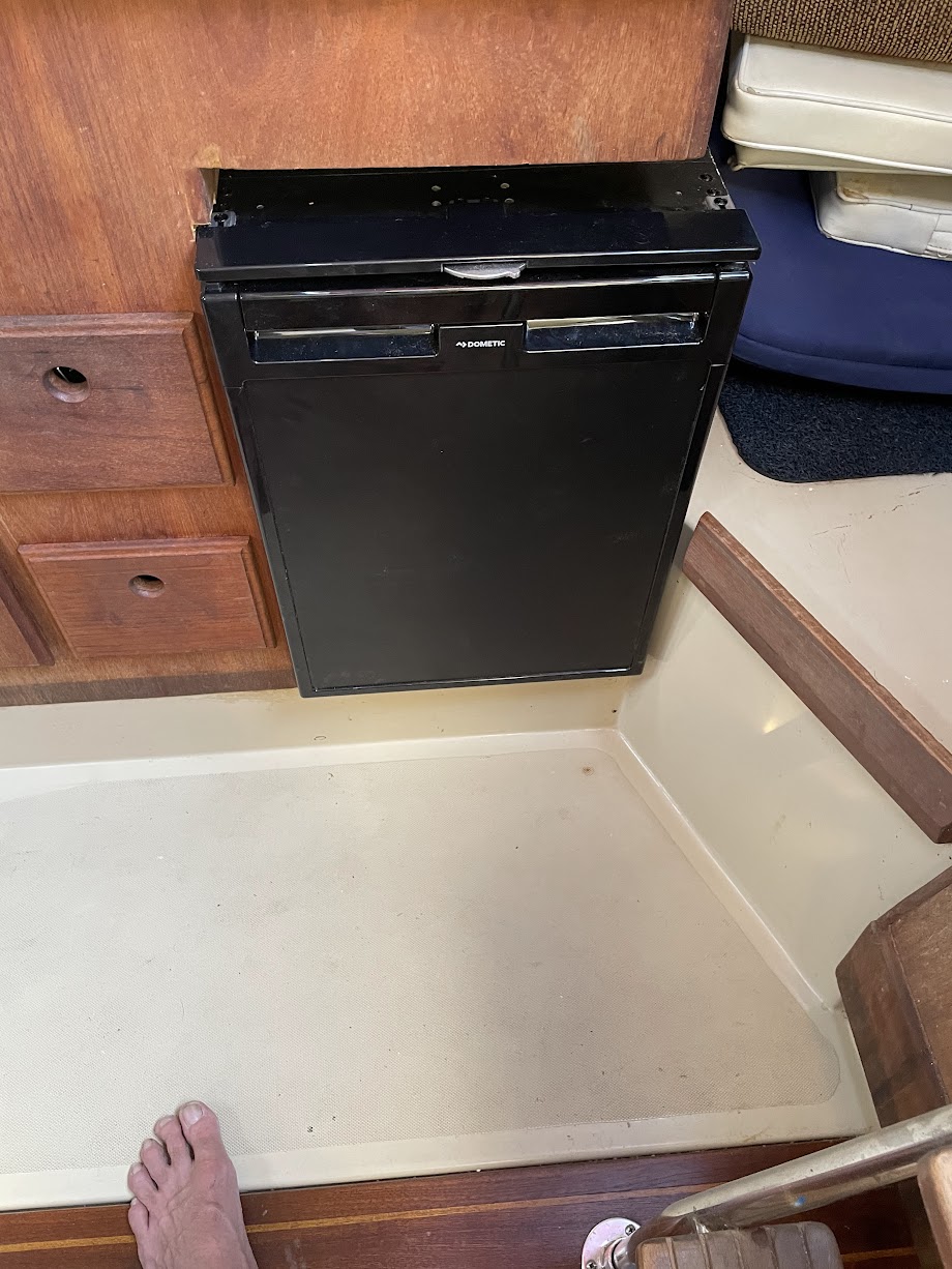

Rather than CONVERT and pay ~$2500+ I bought a Dometic CF-50 and installed (?) it under the nav. station with a webbing strap. It is a PERFECT fit, and has served me well since 2016, including a cruise to Florida from Rhode Island and back. Total cost was ~$700. If it ever breaks, I will buy another.
I use the O'day ice boxes with frozen gallon bottles of water, if I need extra cooling.
Same here. however I had to do a bit of carving to widen the space 1/2".

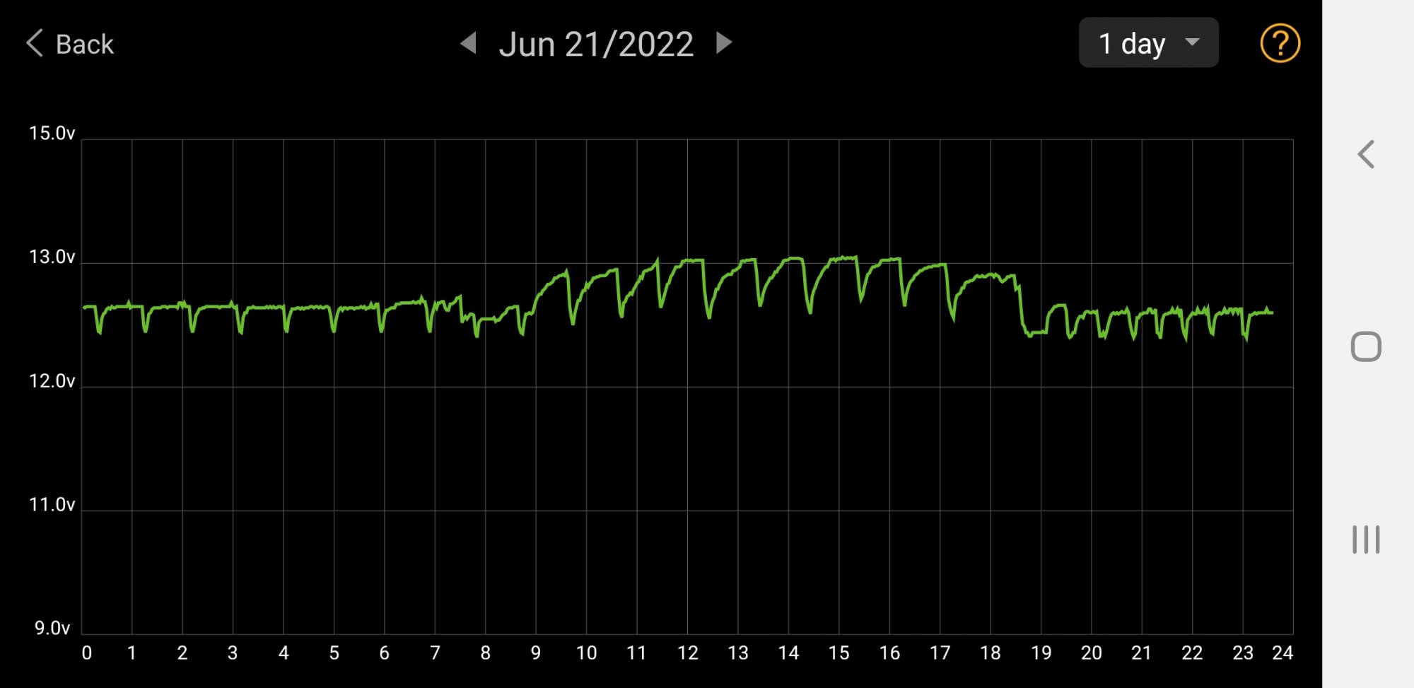

Here is a screenshot from my battery monitor of my Dometic CF-50 refrigerator running while on the mooring with no engine use, only my 60 Watt solar array. The dips in the voltage are predominantly from when the compressor kicks on. Other dips are the propane solenoid (for making coffee), fresh water pump and cabin lighting between 07:00 and 09:00. The refrigerator did not turn on as expected at 18:00, and was on longer at around 19:00, probably because I was messing with the breakers or something.
Thanks for taking the time to post that. Good info.
