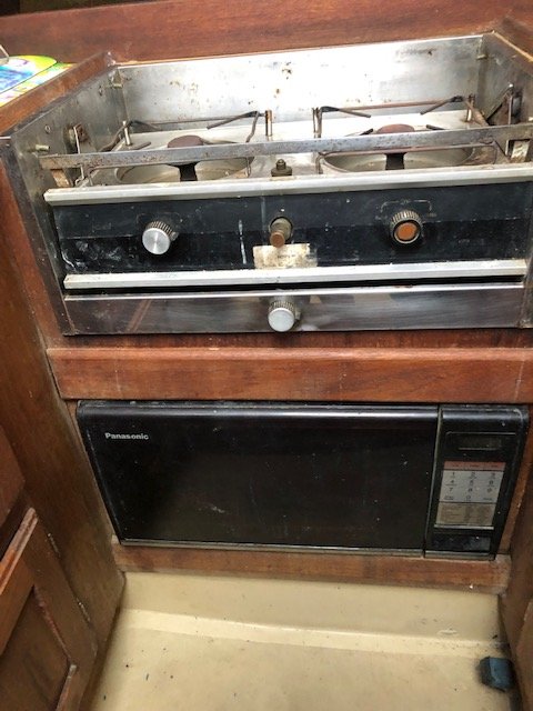

I can't figure out how to remove the microwave located below the stove on my O'Day 34. No visible screws. Any suggestions?

If its a gas model stove, disconnect the system feed lines. Then, I believe you need to take the gimble stove off, (two twist knobs) then remove the entire interior gimble firewall frame/, (should be 6-8 screws). Once that is all out, you should be able to remove the screws holding the base shelf and lift the shelf out. Now you should have access to the microwave.
May 30, 2006
365
Oday 34 Chesapeake Bay
I concur, remove the stove top first, then the tray that the stove top is gimbaled to which should expose the mounting method for the microwave. This is also how you'd get access to some of the galley plumbing should a leak develop.
