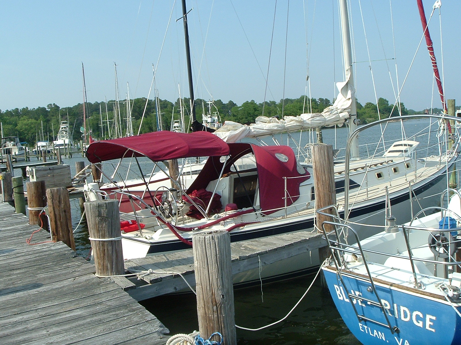

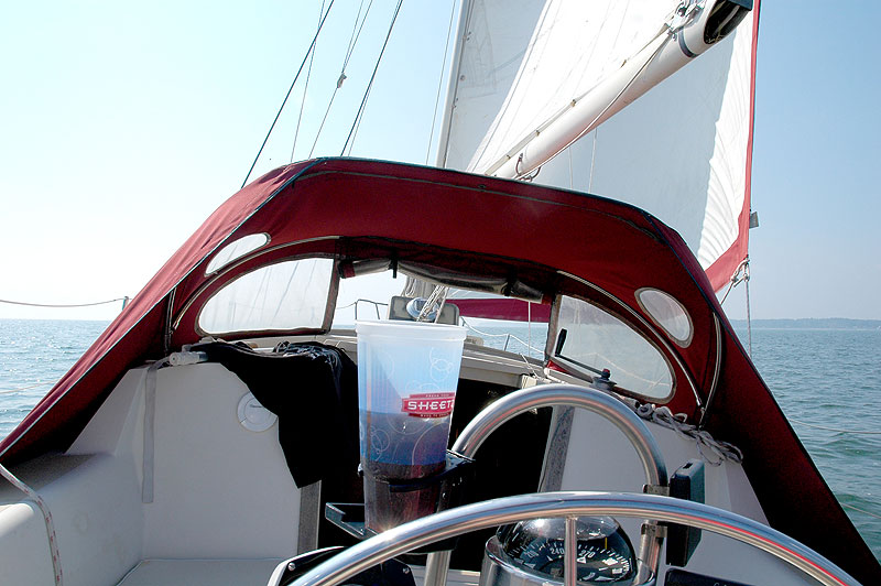

Oday 34 Chesapeake Bay
I too generally sail without the dodger up... until the spray gets cold. Here's some pictures of Karma's dodger, as Jibes stated the visibility is compromised.
I'll be happy to post details if necessary, just haven't taken dodger specific photos at this time.
