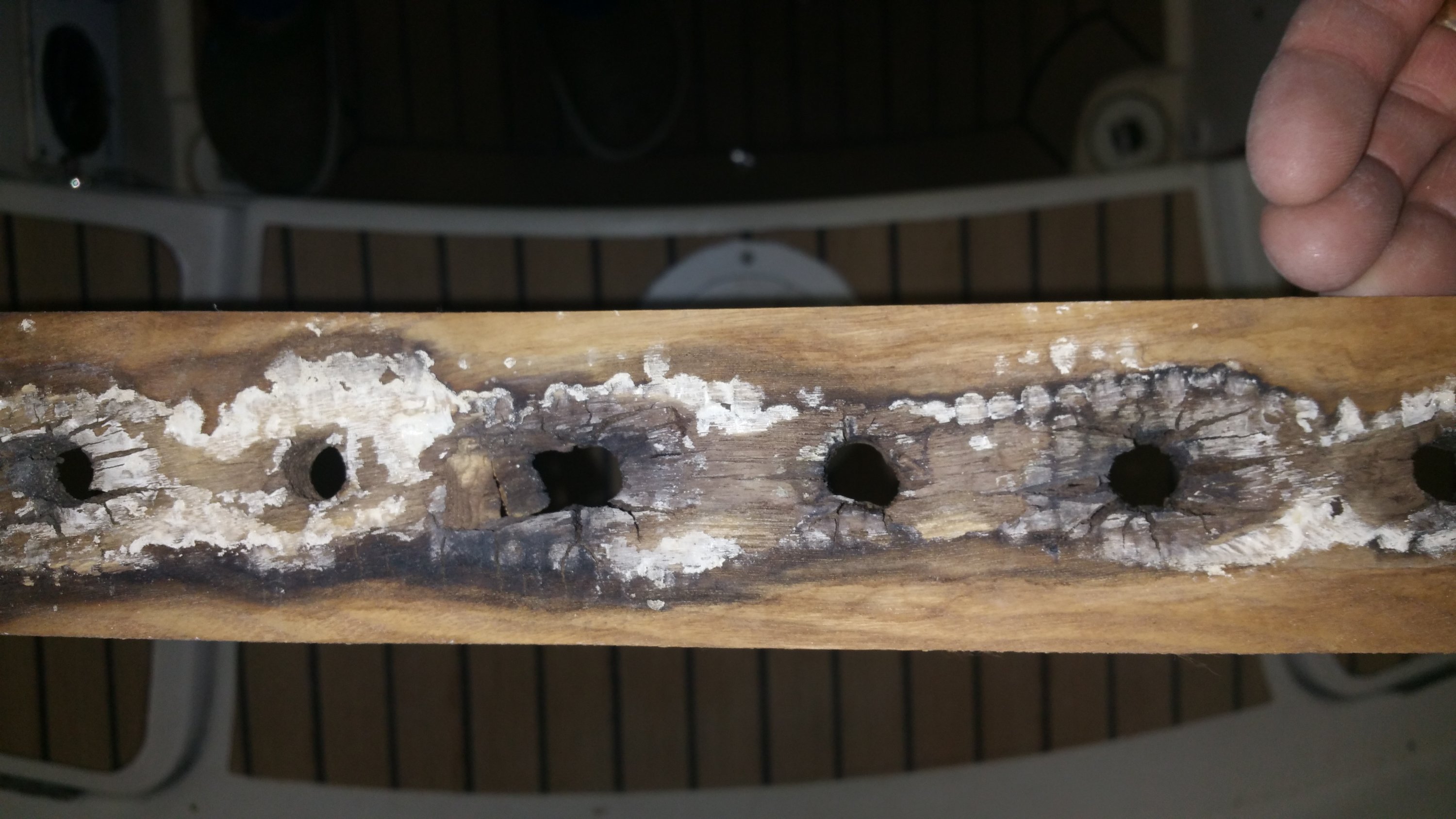

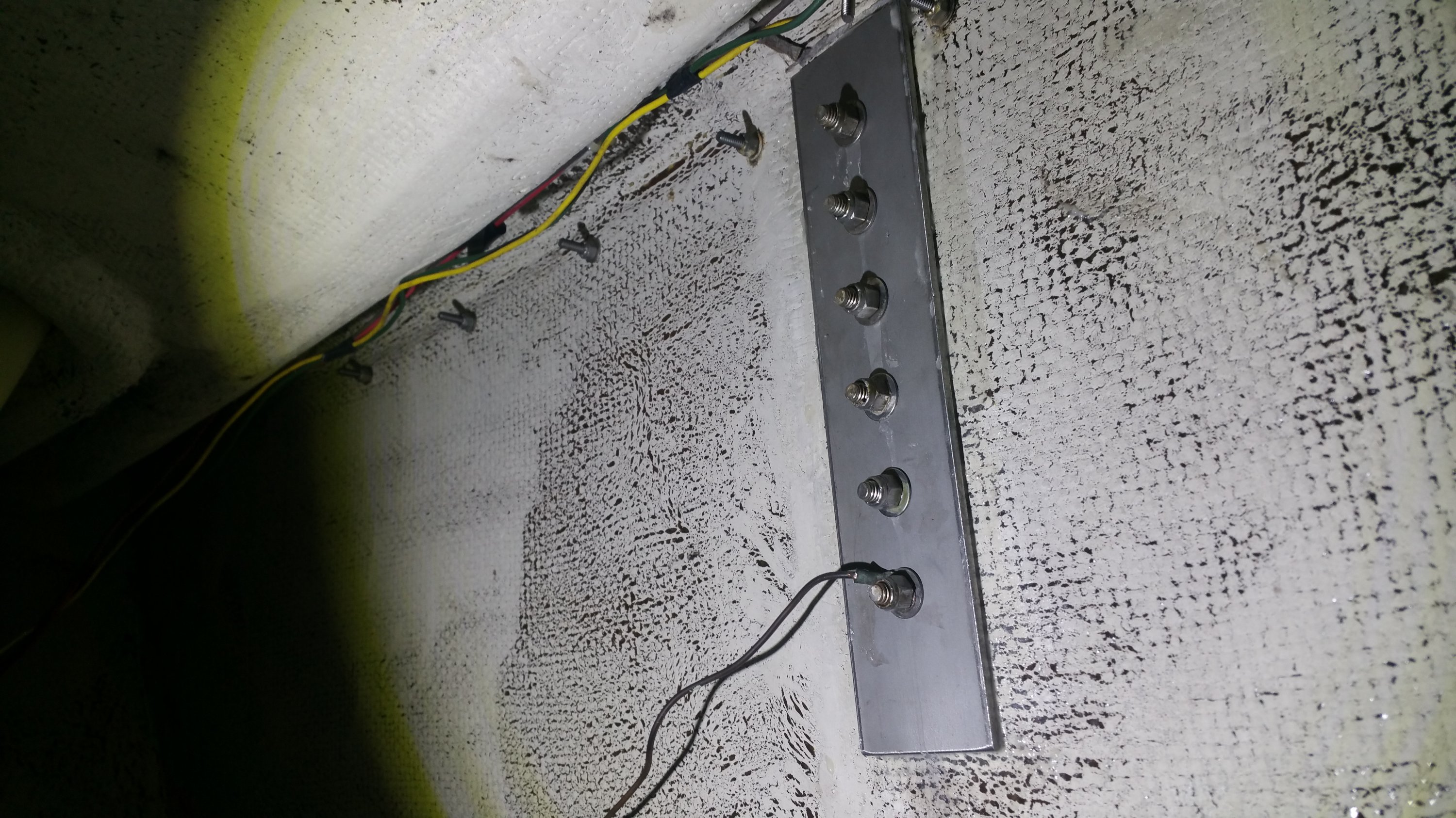

On my not-so-urgent project list was replacing the teak backing for the backstay chainplate. I had a new one fabricated out of 1/4" stainless, slightly larger than the teak one. I bedded it in thickened epoxy and used butyl tape to bed the chainplate and bolts. The old one was in far worse shape than it appeared when it was in place, especially the back side.
The new one is certainly overkill, but hopefully that can be permanently crossed off the project list!

Thanks for posting. I never realized that the backing plate was wood, I'll have to check mine. From the pictures it looks like the backing plate was still structurally sound. Where does the ground wire terminate?
May 6, 2010
472
1984 Oday 39 79 Milwaukee
The wire runs through the bilge, connecting to a keel bolt and the mast, perhaps other places as well, I've never followed it completely.

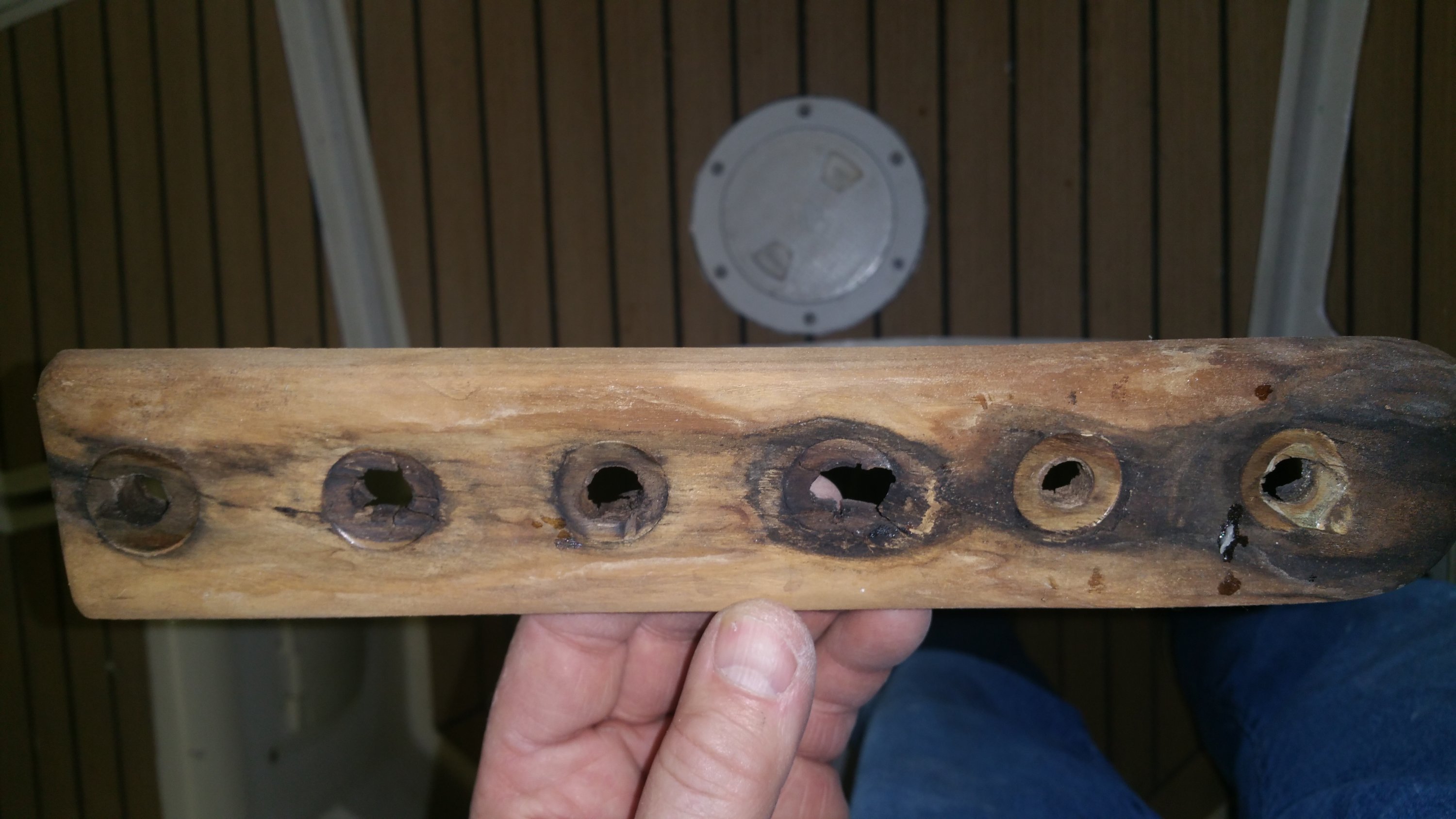

I found that teak in rough shape too a couple years ago. I used plywood to replace it and also went with butyl. G10 would be a good material for this.

I went to the boat today, and I stand corrected. The backing plate on my '87 O'day 35 IS teak;
