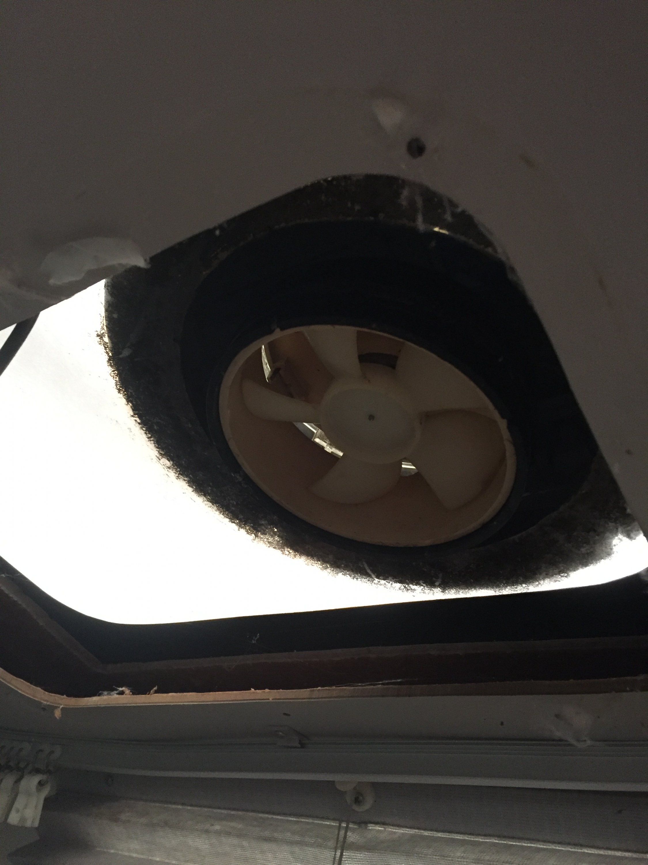

On my list of repairs are the solar vents in the head and aft cabin. One works anemically on occasion, the other, not at all. I see some replacements online. Has anyone repalaced theirs?

We have the same solar vents on the O'Day 302. I replaced mine with new Nico solar vents. When I removed the old vents, I noticed that they were pretty gummed up with debrie and old spider webs. Not something you can see until you pull the blades off. I think the old ones might have been fine if I cleaned them up but I had already bought the new ones. But happy for the new ones. Something to keep in mind: the original O'Day vents are solar powered AND wired to house battery. Newer solar vents can run all night on their own battery power before having to charge up again so you may get away with new vents that are just solar (and cheaper).

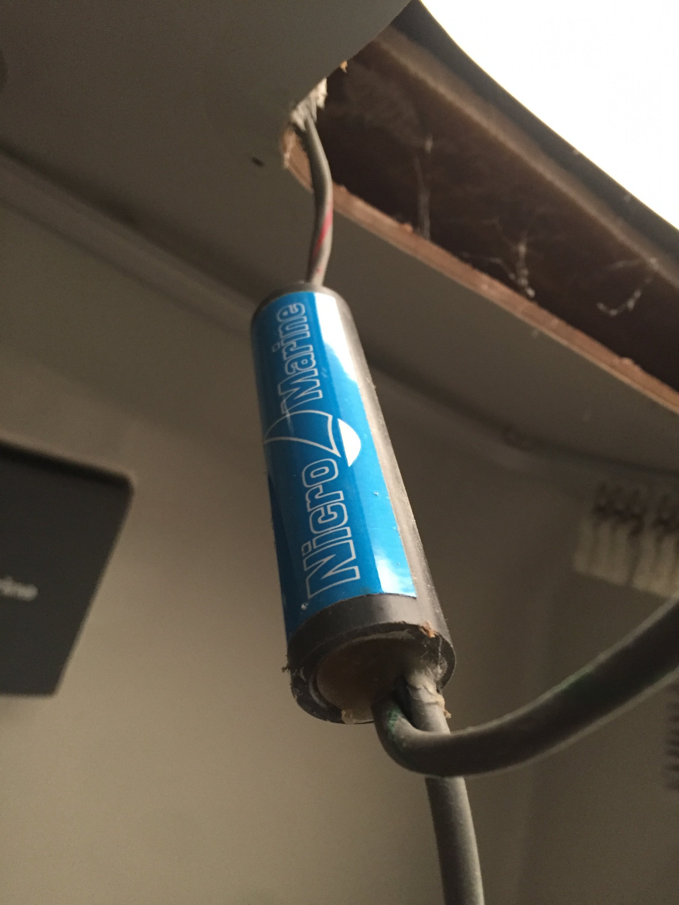

Opened it up the other day, is this the battery?

I emailed Marinco asking about their vents with replacable batteries because all of mine give access to the batteries when the solar array is unscrewed and removed from the top. Anyway, here is Marinco's reply:
"As far as I know, all of the Nicro vents that fall into the “Day/Night” category have a solar array for use during the day, and battery backup for night usage. I don’t know of any of these vents to not have replaceable batteries.

West Marine sells the battery for around $25. Batteries+ can probably match the battery for half that if you show them the old one
