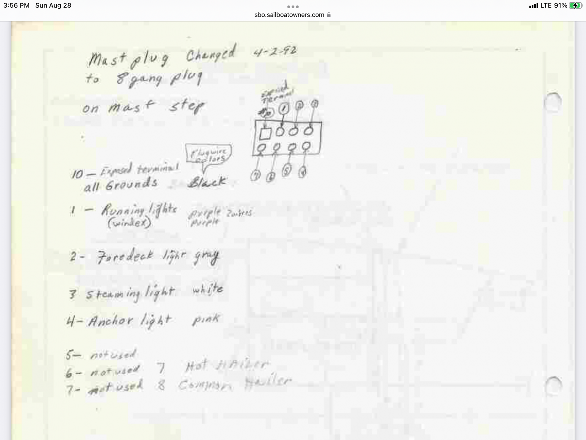

As i mentioned, I have not had to pull my mast, but my owners manual has some notes about a wiring “plug” which I assume is in the bottom of the mast...
The note says the 1st owner changed the plug to a 8-gang plug…

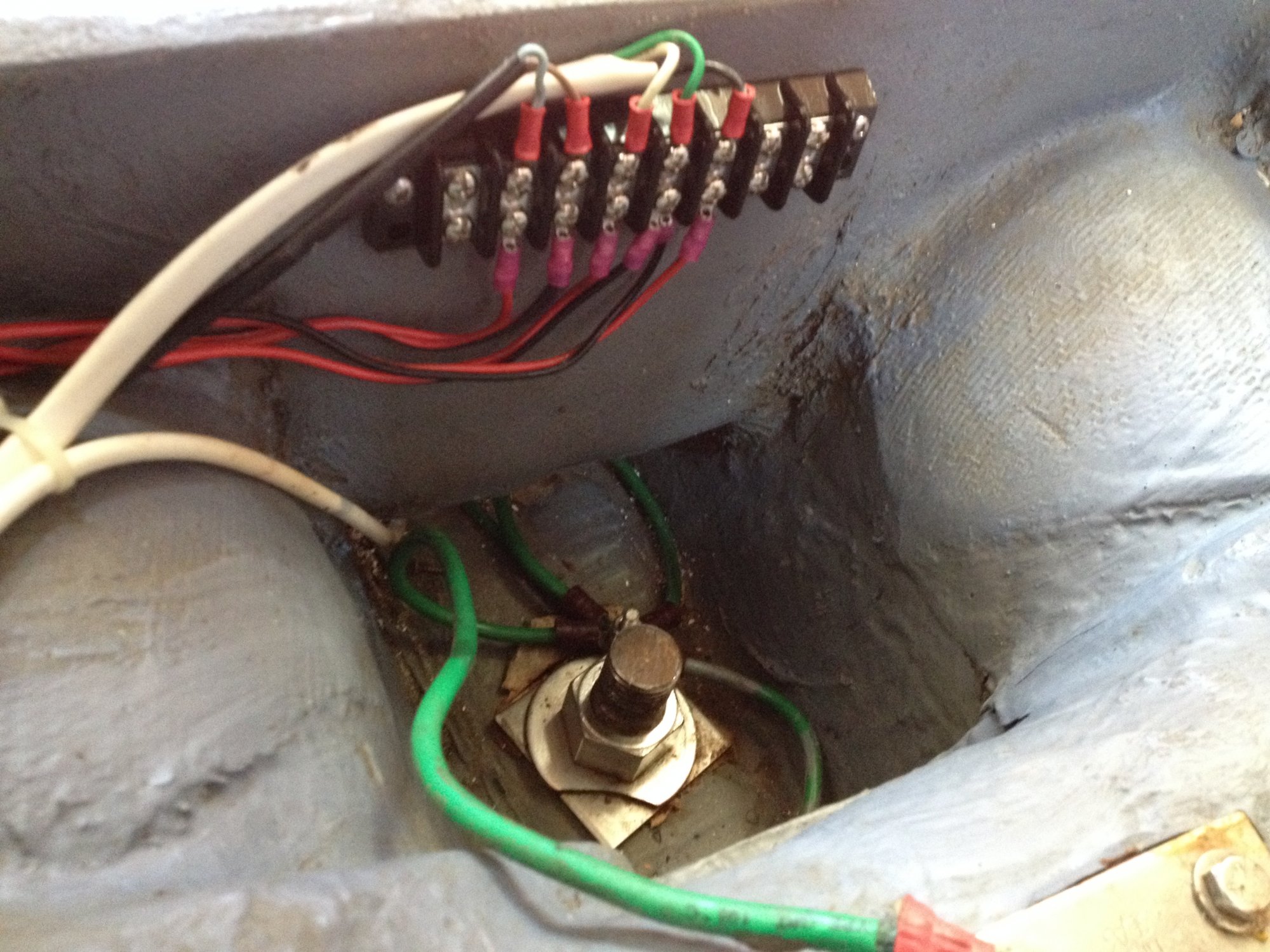

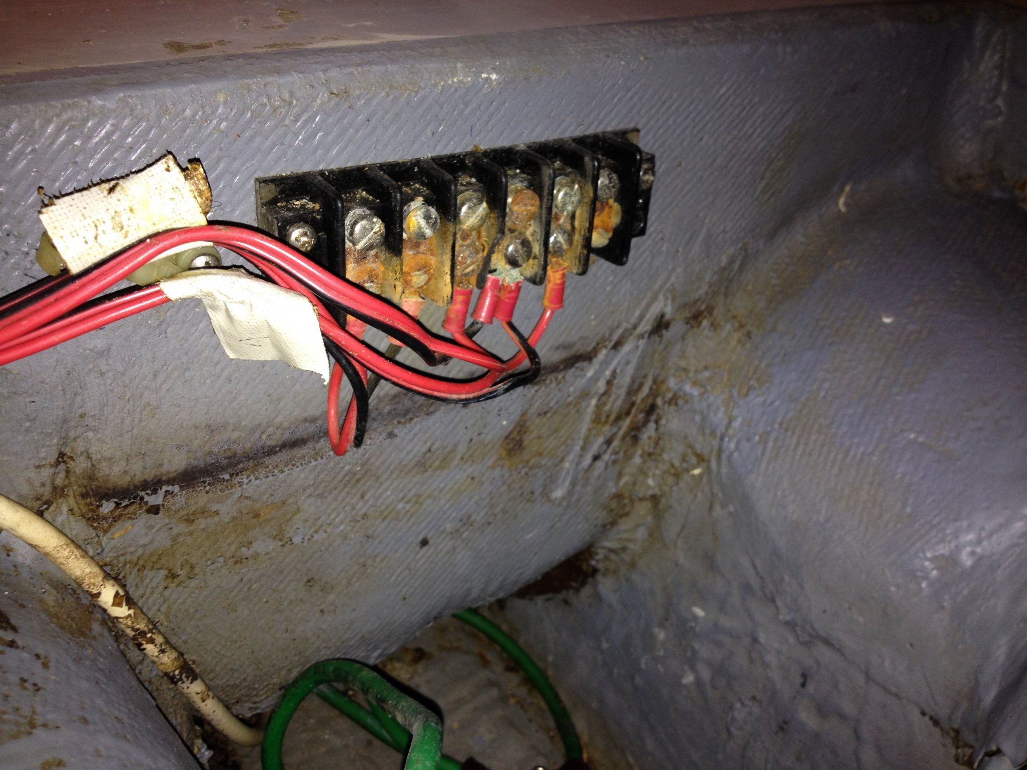

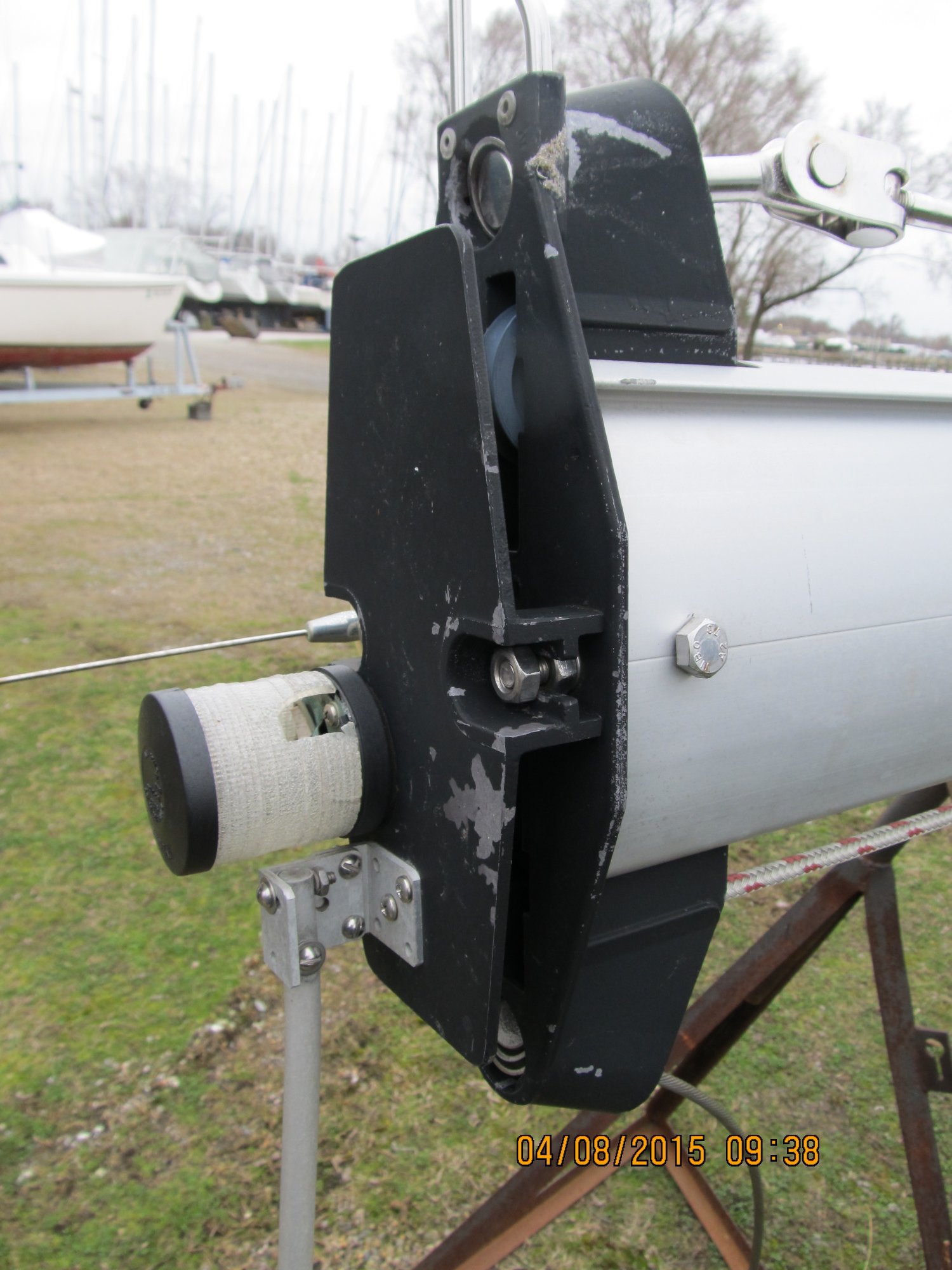

I have not replaced the wiring in the mast. I did however take the mast down to replace all the lights, and sheaves.
I have a 1988 322.
I have no deck plug. There is a tube in the middle of the mast step, and all the mast wiring goes down through it, to an exit hole at the bottom in the bilge, and then a turn to the connection buss. Sorry I don't have a picture of the mast step itself. The wires below the mast bottom are about 6-7 feet longer to make the trip down the inside mast support, exit the hole and to the connection bus. I do however have a picture of the old wiring bus (a rusted mess), and new bus with all new connectors cut back to fresh wire 3-6" or so. Why don't you try that first, and see if that improves the voltage.
The picture of the mast bottom, the 6' extra wire is just stuffed in it , but it looks like the wire that actually goes up the mast travels in that little extruded groove in the side of the mast (to avoid wires slapping during rocking). I do not hear any wires slapping at anchor.
Sorry, it's been seven years. These pictures may help. It was expensive, and definitely a job for a professional crane and marina staff to get the mast down and up. The rest, you can do yourself once it is down.

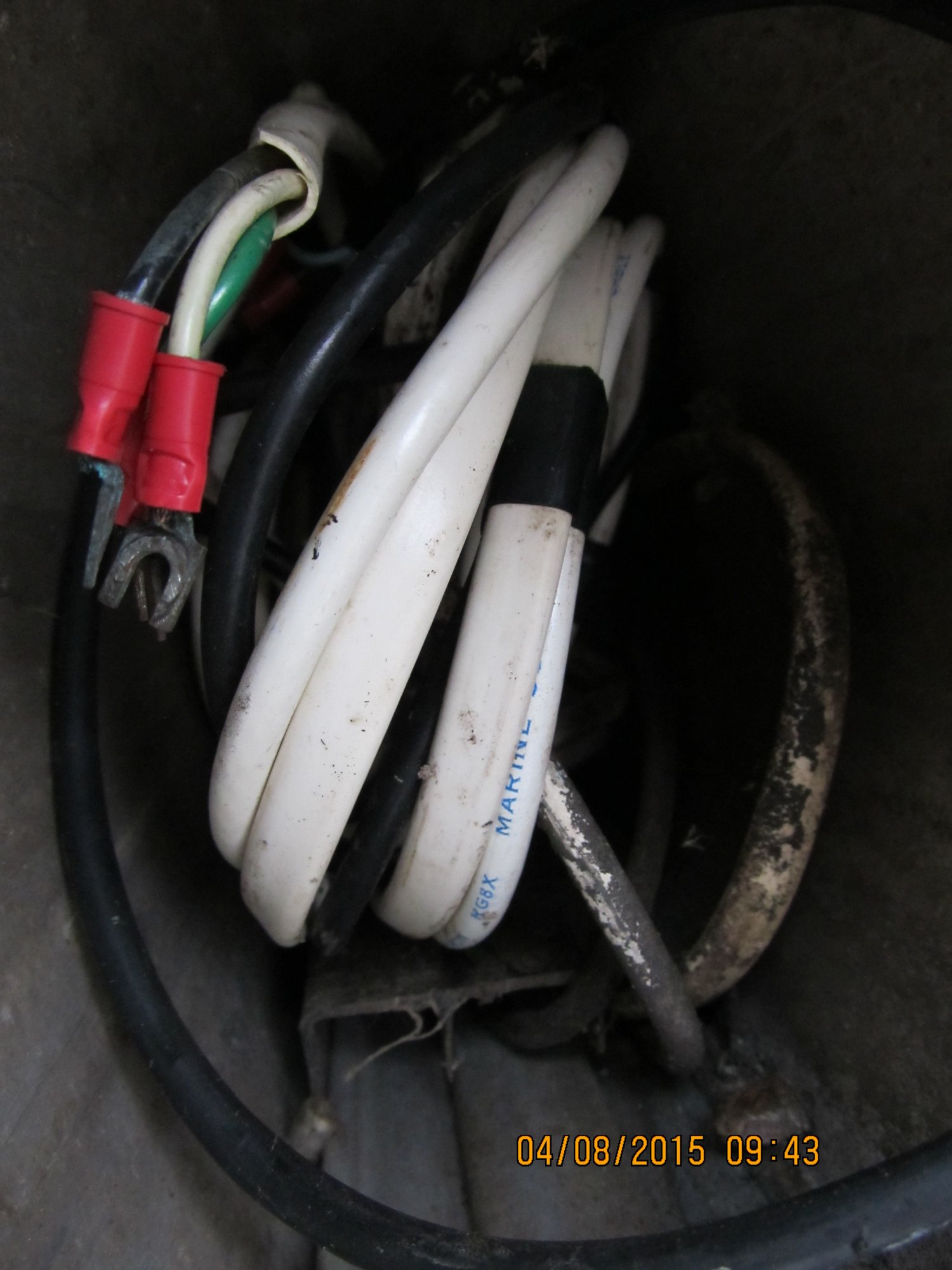

Appreciate the photos and detail but it's clearly different. While you show the mast wires coming to the connector block in your bilge, I have no connector block. Plus I've got red/black wires in the bilge and a different set of colors where the wires come out of the mast so there is a connection between the bilge and lights coming out of the mast. Unfortunately, that sounds like the photo I posted with a plug at the mast step.
