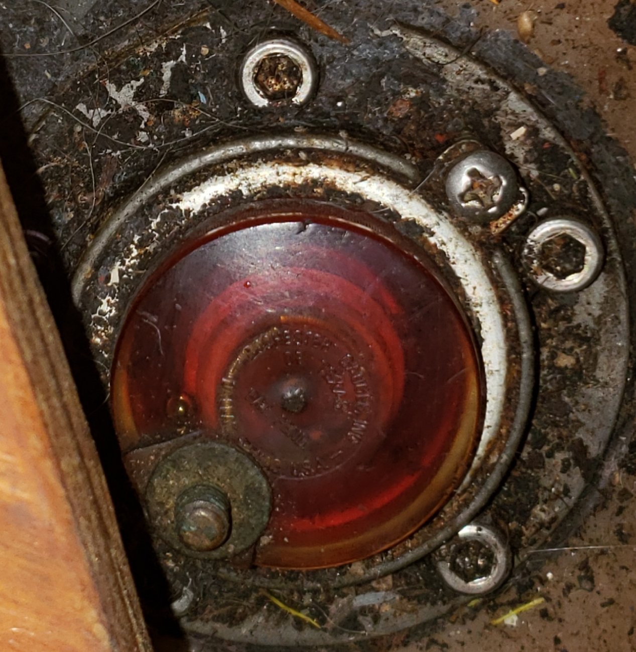

I finally found what I believe to be the fuel gauge in the sole of the port lazarette.
Does anybody know how to read it?

I have the same one on my 322. Pain in the @ss to read. My eye sight is not that great, and I usually need a flashlight pointed down there, or worse yet, have to crawl in the lazerette.
There should be a red marker that moves with the fuel level. I think I can make it out on your photo in the Full position.

Thanks Greg. I think you're right! I did fill the tank recently. I'll watch that red marker to see if it moves. -Alastair.

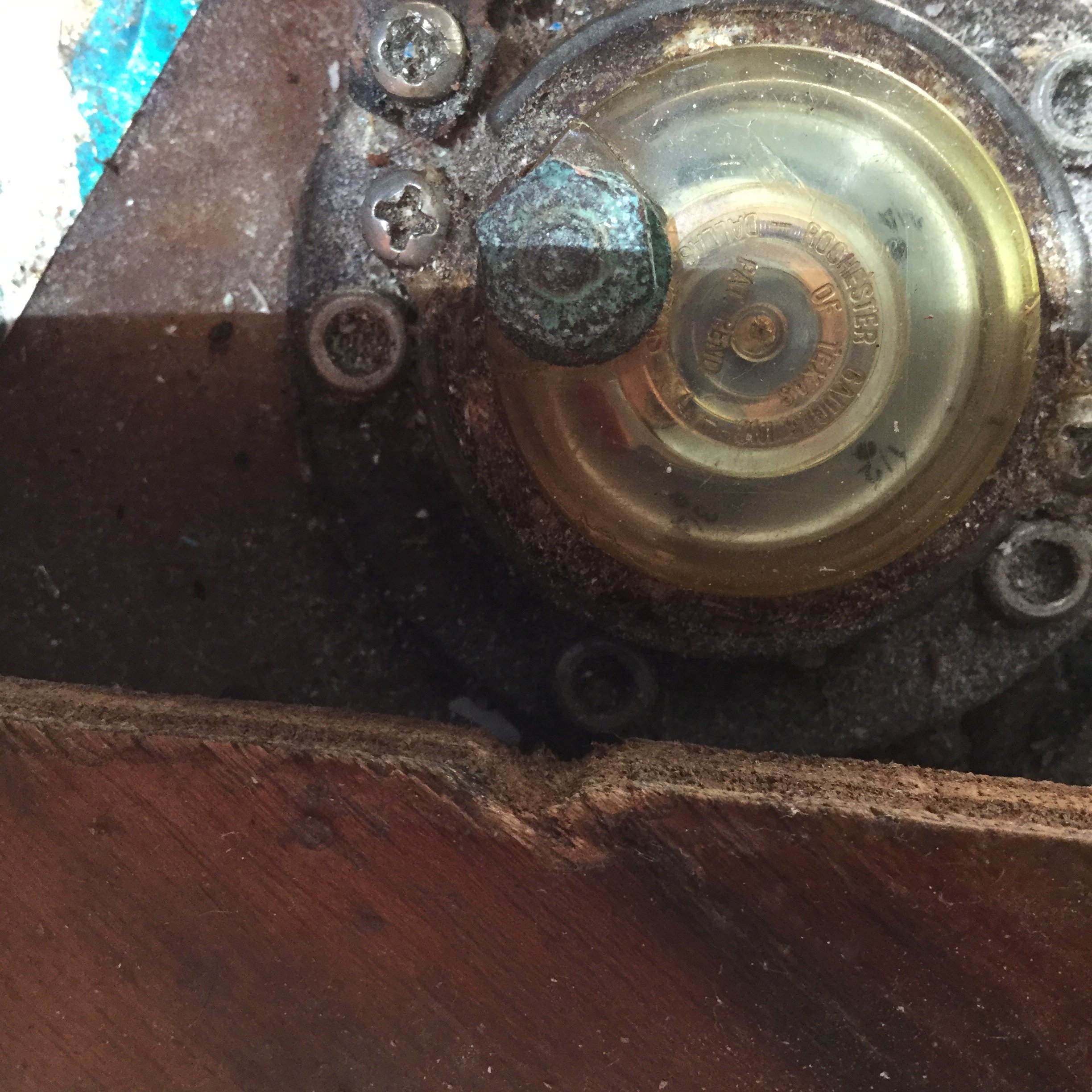

It looks a little different from mine. (See above pics.)
I can’t see any indicator. Can you take and post shots from other angles?

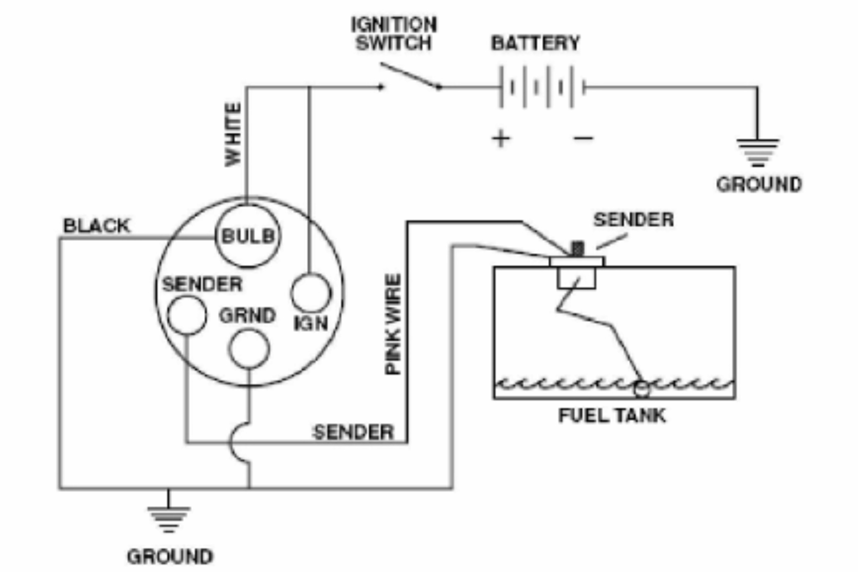

My 28 O’day has an electric gauge and it hadn’t worked since I bought the boat. I replaced the sender which also has the same small round plastic gauge. The float inside the tank operates the same whether a mechanical or electrical sender but the electrical one also has a variable resistor. That didn’t fix the problem and neither did replacing the gauge. I found the problem was the ignition switch where the gauge got its power. Installing an electric gauge is easy, one wire from the sender to the gauge, another from the ignition switch.

@AlastairLC Sure hope you found the answer to your fuel question.
From the image it looked lie you were full. the pink color looks like diesel has filled the sight glass.

That plastic fuel gauge looks exactly like the one on my O’Day 28. I have an electric gauge on my instrument panel and thought I had traced the problem to the sender in the tank. I called Mirax, the tank manufacturer and they were extremely helpful in shipping the correct sender for my tank. Turns out my problem was the 12v feed from the ignition switch to the gauge but now I have a nice new gauge and sender. On my boat that stud sticking up from the plastic gauge connects with a red wire to the “sndr” connection on the gauge. 12v from the ignition switch connects to the “ign” connection on the gauge and then ground the “gnd” connector.
From the image it looked lie you were full. the pink color looks like diesel has filled the sight.
The fuel indicator is separate from the tank, so I don’t think that the pink color is fuel. The sender is isolated in the tank, and the gauge is moved by a magnet as I understand it.
I added an electronic gauge that is set to the same ohm reading as the fuel sender. It is reading full, as is the gauge on the tank but I do not think the tank is full. In some bouncy cease last week, the fuel gauge moved, so something is moving and working, but I don’t think it is working right.
I don’t know if there is a right way and wrong way to set the tank gauge on the magnet.... that seems to be the problem.
