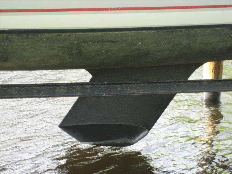

Has anyone looked into the possibility of lengthening the O'Oay 32 winged keel? I think it would have better upwind performance if the keel is 2 feet longer. Does anyone know how this could be accomplished?

Contact Mars Metal at marskeel.com. They do that kind of thing but I'm guessing you'll find it very cost prohibitive.

The 32 did not have a wing-keel, only offered with fin-keel or shallower keel/centerboard.

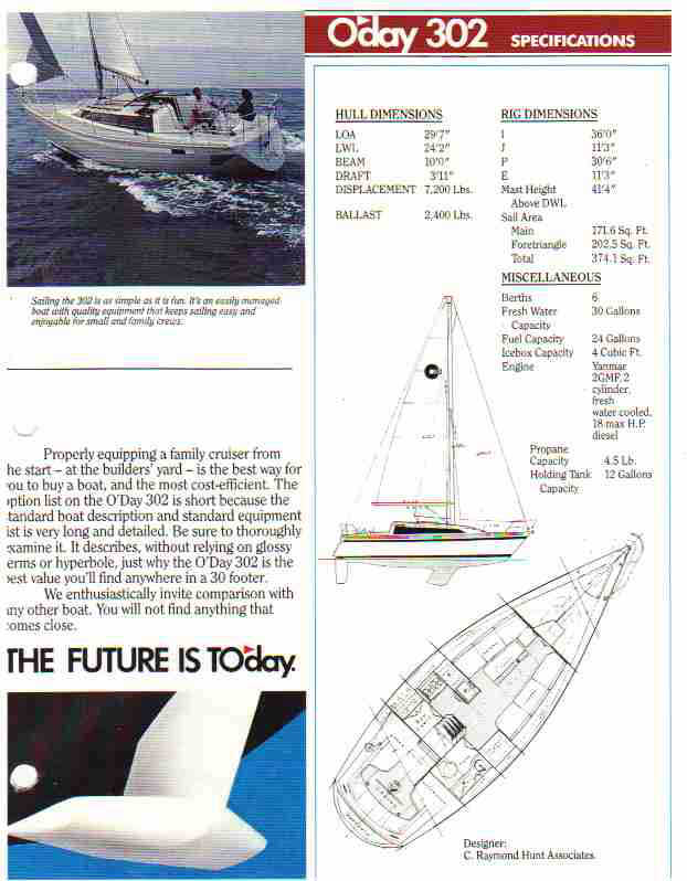

The wing keel (Hydrokeel) on the later 322 and 302 was designed to be just as it is, adding length is not really possible and would most likey throw the balance of the boat off by moving the center of lateral resistance aft. The vertical fin of hte wing-keel will develop lift as it moves and that prevents leeway. Also if you make it longer fore and aft the boat would not turn as easily. See below info from the 302 Brochure (pretty much the same was in the 322 Brochure.)
