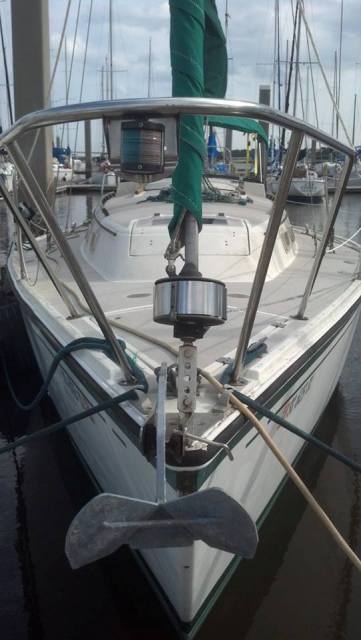

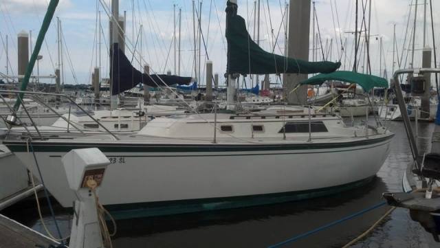

Hello folks,
I recently purchased my first sailboat - a 1984 Silver Anniversary O'Day 31. She's a beauty and I'm living aboard so we're getting to know one another well. I'm digging into the systems that need attention as they present themselves, and finding my footing on several steep learning curves.
