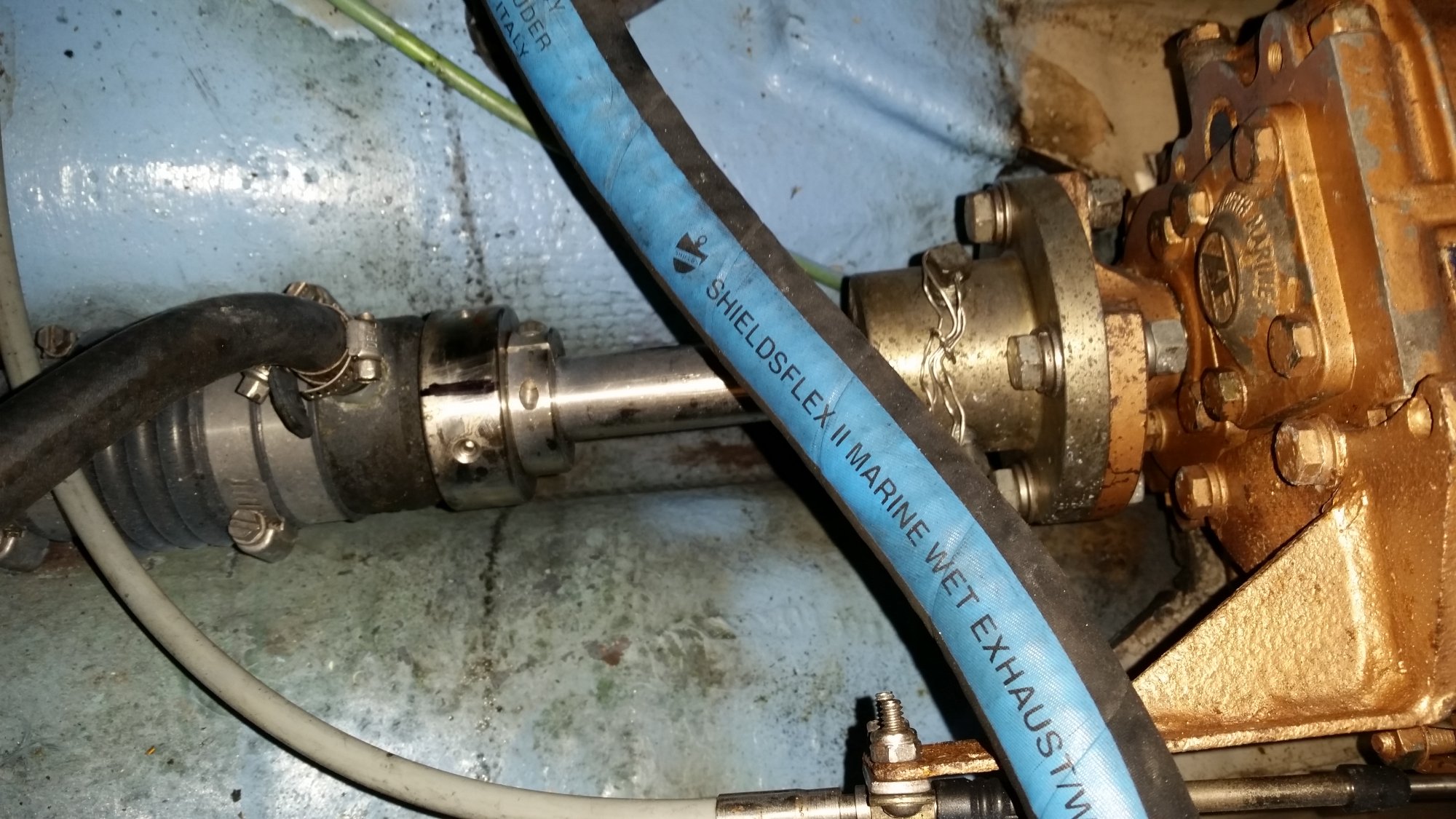

I replaced the stuffing box and shaft log hose on my 35 with a PSS Shaft Seal in 2013. No drips, and no moisture in the bilge from the shaft. In 2020 I replaced the bellows on the PSS seal per PSS recommendation of 7 years. Based on how well the bellows and graphite seal looked, I will leave the current bellows installed until 2030 at least. I know that there are some people that let them go longer than 10 years.
