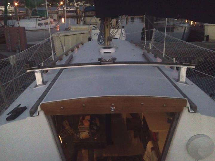

IMHO flat is better than arched as mainsail twist does not change when adjusting angle to wind with the traveler. Last fall I moved the traveler on my 27 from mid cockpit to cabin top. I did use a slightly arched hatch bridge as I didn't want the traveler too high. I love it out of the cockpit.

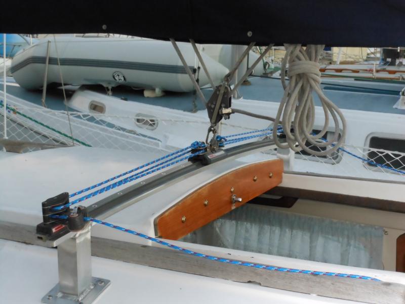

Another photo. Note that it is important to spread the sheet load to more than one attachment point when you move your traveler that far forward.

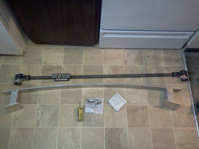

I through bolted it with backing plates. I don't think I have a pic of the backing plates. I'm going to the boat today. I will try to remember to take a photo of the them. No guarantee on that however. This photo shows the backing plates uninstalled.
