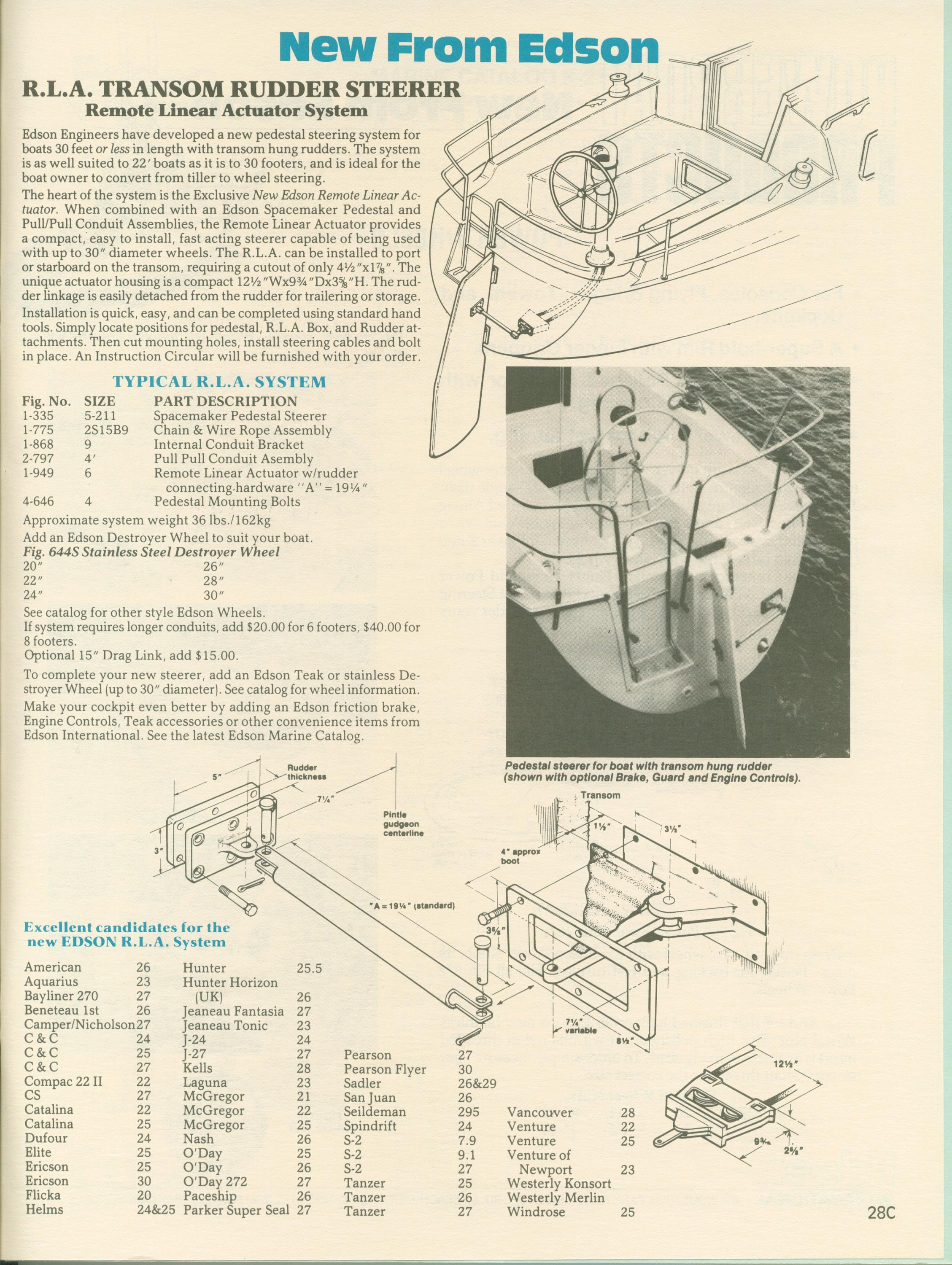

Pat, EDSON did make the RLA (Remote Linear Actuator) system that was more or less specially designed originally for the 272, but that is just one of MANY systems that they made and it was only for outboard rudders. The setup for the 28 was a more traditional setup with a quadrant mounted to the rudder shaft. The O'DAY 280 used the RLA system (the 280 was really just a 272 hull with a different deck, so a 28' boat that only measured 26'11" LOA) the 280 ad the 28 are two VERY different boats. The Steering Data Sheet (PDF) attached shows the setup for the 28, it uses the "Radial Drive" instead of a quadrant, but a quadrant could be used if 2 more pulleys are added to the setup, or those "Pull-Pull" cables used with a special conduit bracket. Unfortunately for 272 owners (as well as many other O'DAYs with outboard rudders) the RLA is no longer available, although EDSON has introduced a pretty slick alternative, that I do not have a drawing of ready to post.

You are correct....the RLA was a fabulous system that was (is) extremely sensitive as it is a pull--pull system..A lot of people have been at the helm of our boat and cannot believe it is as sensitive as it is...makes sailing in a breeze a pure pleasure. Pat
