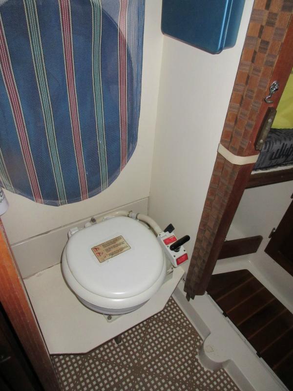

I have a 1981 Oday 28 on freshwater lake. 15 gallon holding tank under V-berth.
The marine toilet bowl refills slowly (from holding tank) after pumping boal dry. This happens with lever on "Wet" and "Dry" settings. Never overflows, just fills about 3/4 full to about (I assume) waterline of boat.
Holding tank about half full.
Would a backflow preventer or check valve help? Any other thoughts, ideas?
