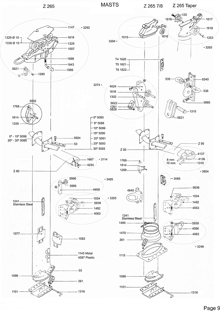

Has anyone replaced their mast foot and base on a Z Spar mast with 6 sheeves in the mast foot (I only need 3 sheeves). The mast foot which is a Z Spar part # Z260SF-10/2P. The hinge pin part of mine is broken and the replacement part is no longer available. If you have replaced yours, what did you use? RigRite and D&R marine do not have the part.
Is there is such a thing as a Z260 mast? Never heard of it. Do you mean Z265?? My first 260 uses that as well and US-spars has all the parts.
Dec 5, 2015
117
Oday 272LE Louisville, KY
Yes, the Z260SF-10/2P is the right part number. It came from RigRite's website and I also talked to them. They cannot get the part from Z Spars in France. My mast foot and base do not match the ones that you attached. My mast has internal halyards with 6 sheeves in the mast foot.
Gotcha. Those old mast bases with the integrated rollers were generally despised and quickly phased out. Early Beneteau 235s used them with the Z190 mast, and when they switched to the more modern design with loose blocks on the tabernacle, people who broke the old base had to use the new one, with a 1.5 inch shim under the mast to make up the lost heigh of the old mast base. If one of the existing masts has the same section (Z265?) you could do the same thing.

I have been conversing with USSpars and it appears that the System 265 base upgrade kit will fit my mast. I measured the height of the mast sheeves on the old broken mast foot and it is 2 3/4" inches high. Since that the 265 kit doesn't have sheeves, I can cut slots in the mast for the lines to exit and add deck blocks. A sailboat dealer mentioned shimming the height with a material called poly core but it is only 1 1/2" thick. Does anybody have any ideas of how to shim a mast at least 2" that will not look strange and also be stable? Thank you for all of your comments and help.
I'll let other speak to the material to use, but it will not look strange at all. The spacer will go below the deck plate and holder for the blocks, and looks perfectly normal. BTW, you'll love the external blocks. With the halyards exiting the mast at shoulder level, you can jump your halyards at the mast. A huge deal if you ever fly a spinnaker.
