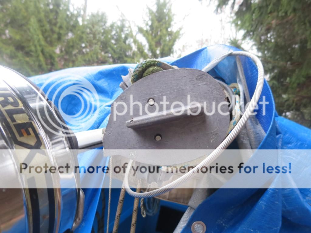

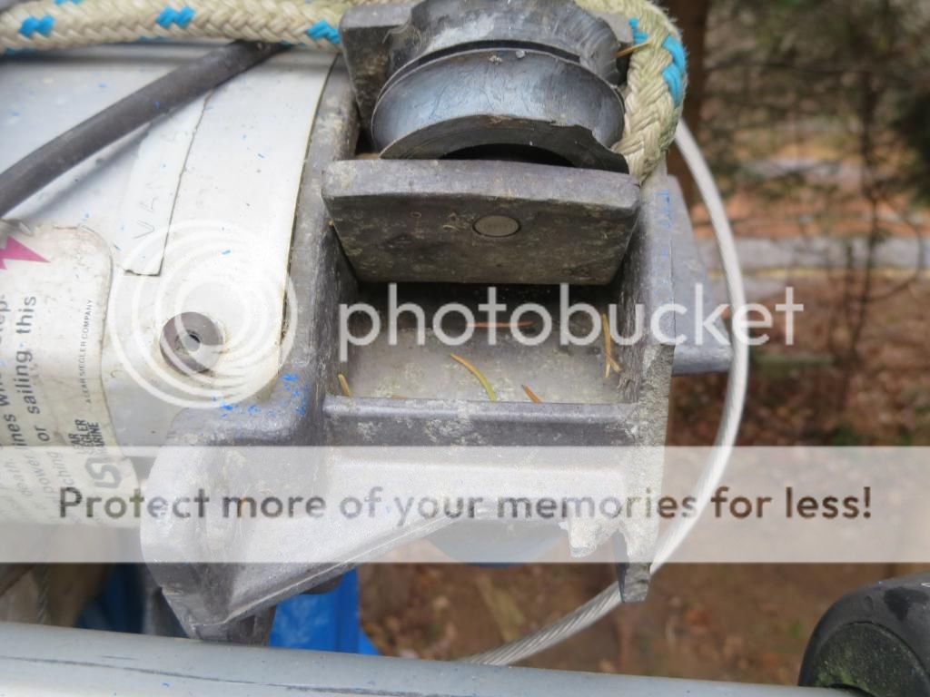

So my new "old" 272 Oday needs a new tabernacle and I would like to have the ability to step the mast myself (with a few friends of course). Any suggestion with pics that other owners have switched to? Thanks

So if our ODay 272's have the Z260 mast foot with sheave by Rigrite, you can attach the large tabernacle hinge by say D&R Marine to the underside of the Z260? I guess you would have to grid off the aluminum stem on the bottom of the foot to create a flat surface for mounting the hinged tabernacle?

I don't see why you couldn't create a new pin at the base of the tabernacle. Perhaps bolt a bracket with a pin to the tabernacle, and bolt a bracket with a receiver to the step plate. Or maybe redrill the pin to a larger size and bolt on a receiver? There has to be a way to fix this without having to replace the part or the whole mast because the part isn't available. Also, considering the size of the pin and receiver versus the mast and the forces implied, that little pin ain't doin' much! That is probably why they break. Just a slight twist as the mast comes down, and that pin is a goner! Additionally, I can't see that the pin does anything in terms of keeping the mast stepped. The stays, shrouds, and the stem see to that. That pin seems like an afterthought that is occupying too much energy to fix. And yet... I am reluctant to go without some locking device at the foot of the mast.
By the way... The pin is broken on my 272... broke while lowering the mast when I bought the boat this Summer. Grrr! ;)

That seems to be in the direction I would like to go. That hinged M-30 seems nice and beefy! Since I have the Z260 setup already (see pic on top of thread) and if I replace it with a different foot without sheaves, would I have to install exit sheaves near the base of the mast for my internal mast halyards?
