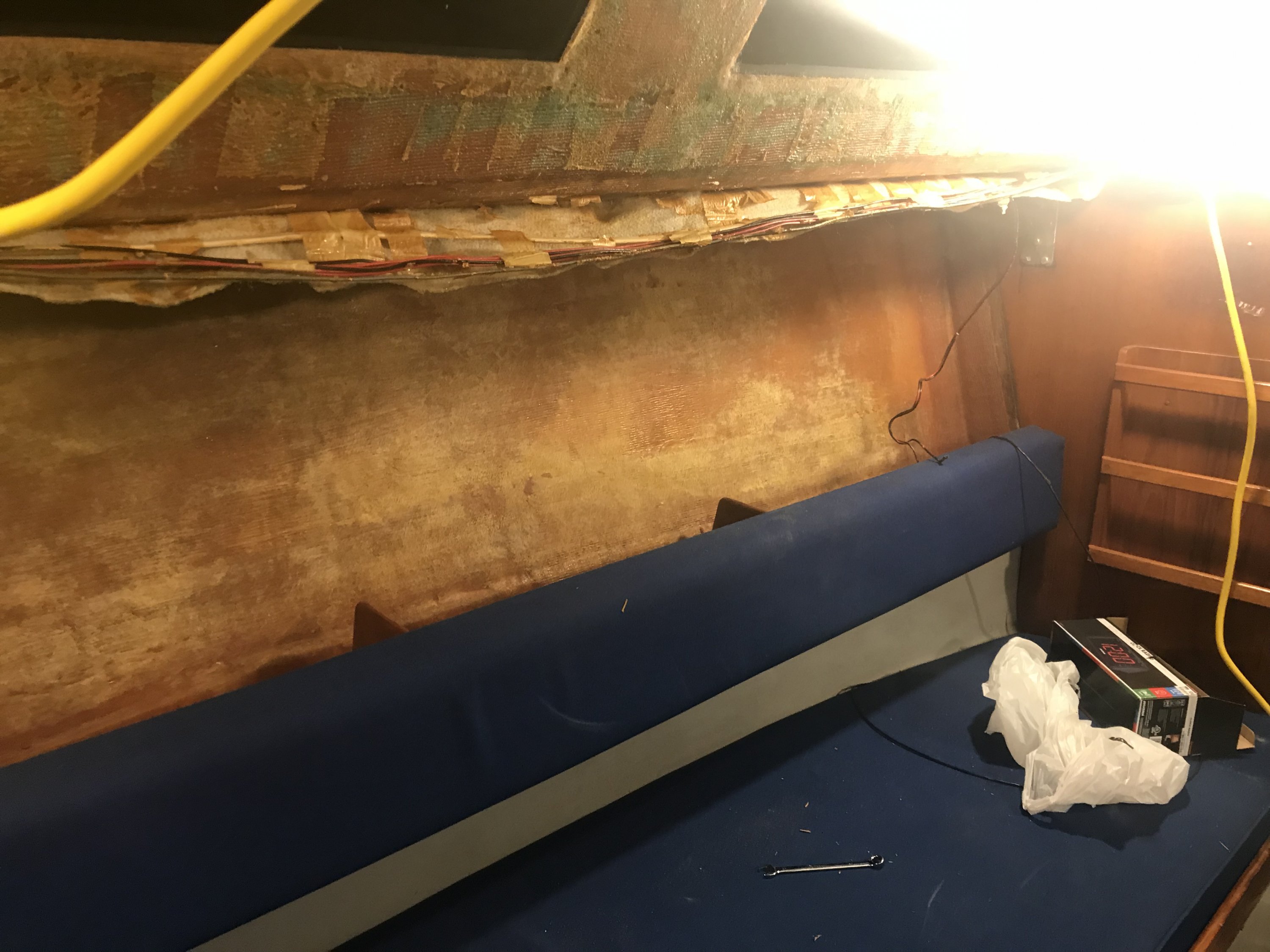

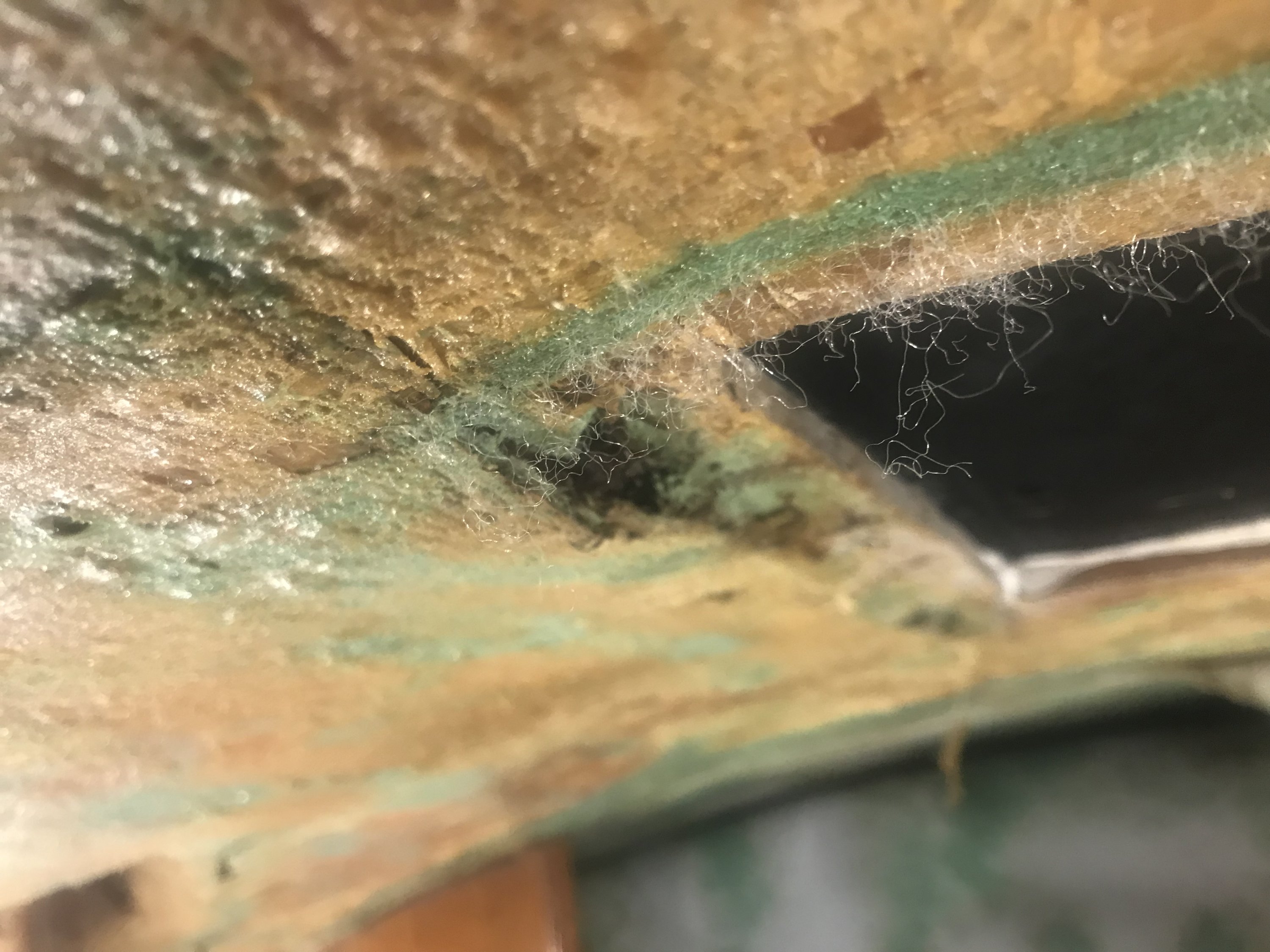

1st area of concern. If you look real close at the edge of the window you can see a dark spot. That’s exposed wood and yes it’s wet. Planning on doing a few test drill holes from the bottom tomorrow to see how far it goes.
Question is, can I repair the core from the bottom side? The top of the boat looks really good with a few cracks but nothing really bad. Unless I have extensive core issues I really don’t want to start cutting up the top sides.
Oct 19, 2017
8,195
Hillbilly,
I can't imagine why you couldn't do just that. It would save a lot of work, as long as you can get to the whole area.
I was taught to kill the dry rot with bleach and then use a large syringe to fill the area with resin.
You may not have to open the whole area up as long as the rot is stopped and the core can be made sound again. It would be important to find the edges of the rotted core so you can be sure to keep it from spreading.
