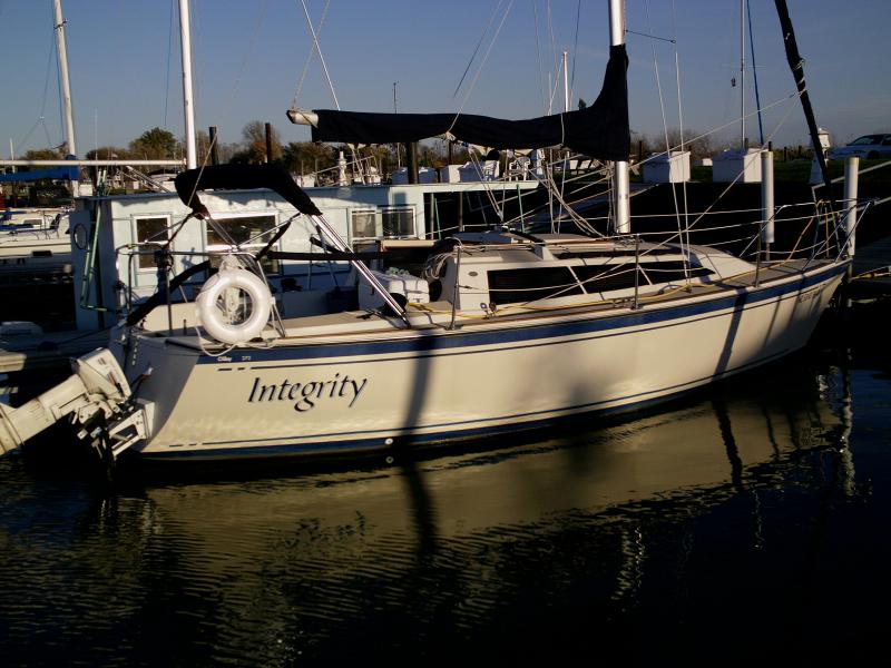

Needing advise - experience - suggestions:
Oday 272 equipped with a 1986 9.9 Johnson extra long shaft and the original lift mount. Boat has tiller helm.
Need to make a "wise educated choice" for replacement aux. power, mount and Controls?
9.9 HP appears sufficient; but, reaching over stearn to shift and throttle has created one to many exciting docking events.
Best Mount:
Best Motor:
Best Remote Control and placement if needed:
Regards, John

your oday 272 needs remote controls
i have the same boat and motor with a CMC tilt and trim from cabelas and an old, used johnson sailmaster throttle and shift control. i mounted the throttle controls on the starboard side of the cockpit in front of the gas tank locker. it made all the difference in our sailing experience.
