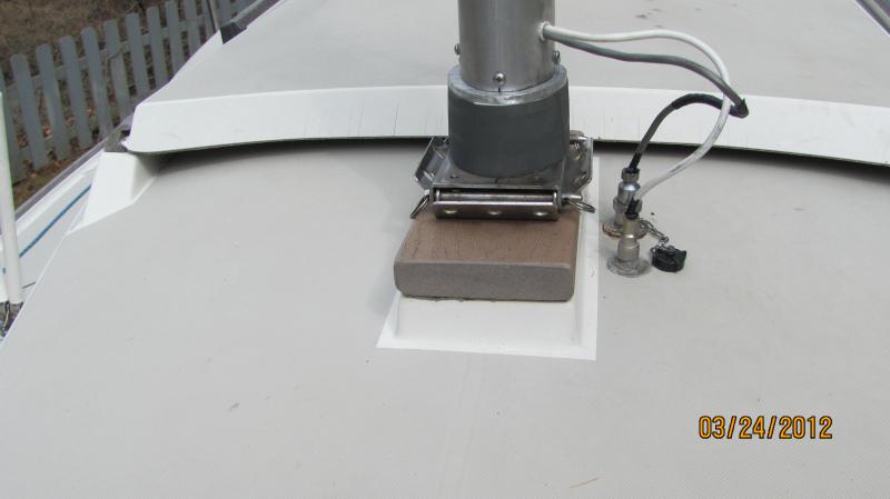

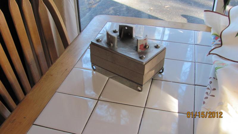

I built a mast extrusion for the foot of my mast out of this stuff a few months ago I just added two more 1/4" X 4.5" stainless steel bolt to it the other day.
Last year the bottom of my mast corroded and I had to cut 2" off it. I Mickey Moused it with some Trex to get me through the rest of the summer and this year I came up with a more permanent solution with the PVC FB.

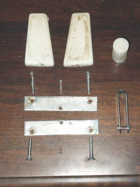

Were the original wedges missing on your boat or did they get broken when you tried to remove them?
When I removed my wedges they got slightly broken and I wound up reconstructing them with epoxy and filler and using them over again.

Good idea, Tom. I have the old ones out of the boat. A friend and I have discussed using the outline of these to make some prototypes out of "1x" stock to get an idea of what the correct thickness should be (or, what we'd like it to be :) ). The old ones are in rough shape.

I've mentioned this stuff a few times on this forum as a possible good material to use for a transom block because it can be glued with PVC cement. As you probably know from my ramblings, I used AZEK to construct a mast extrusion to gain back the necessary height I had to forfeit when I had to cut 2" off the bottom of my mast. So far it's worked out just fine. I recently removed it and added two more 1/4" bolts to it and stuck it back into my mast.
