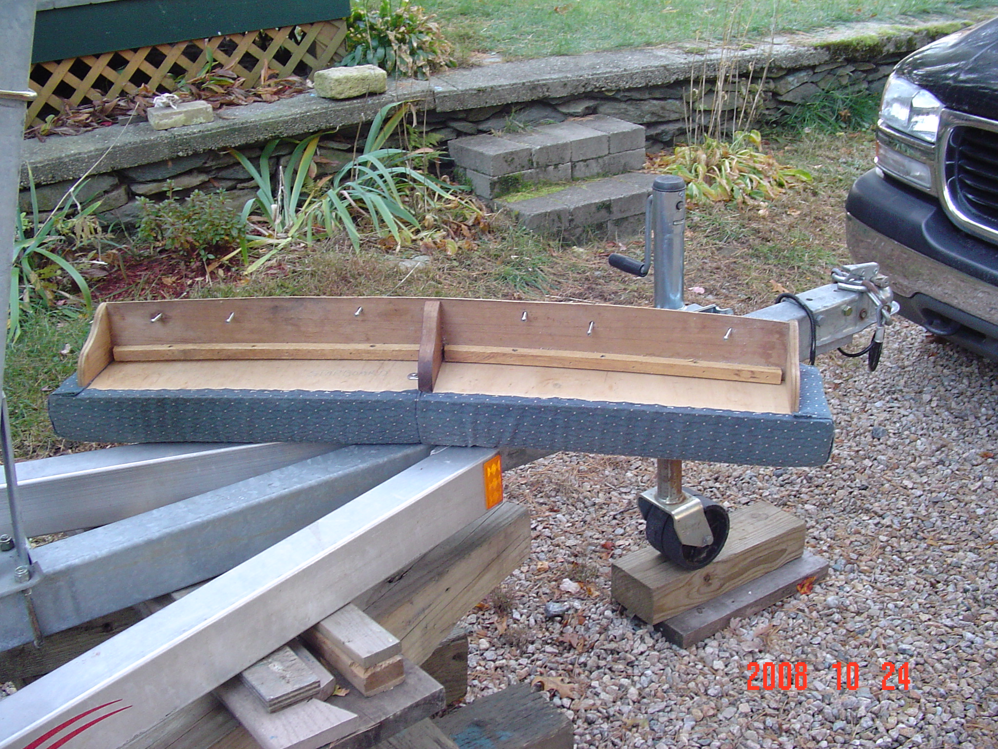

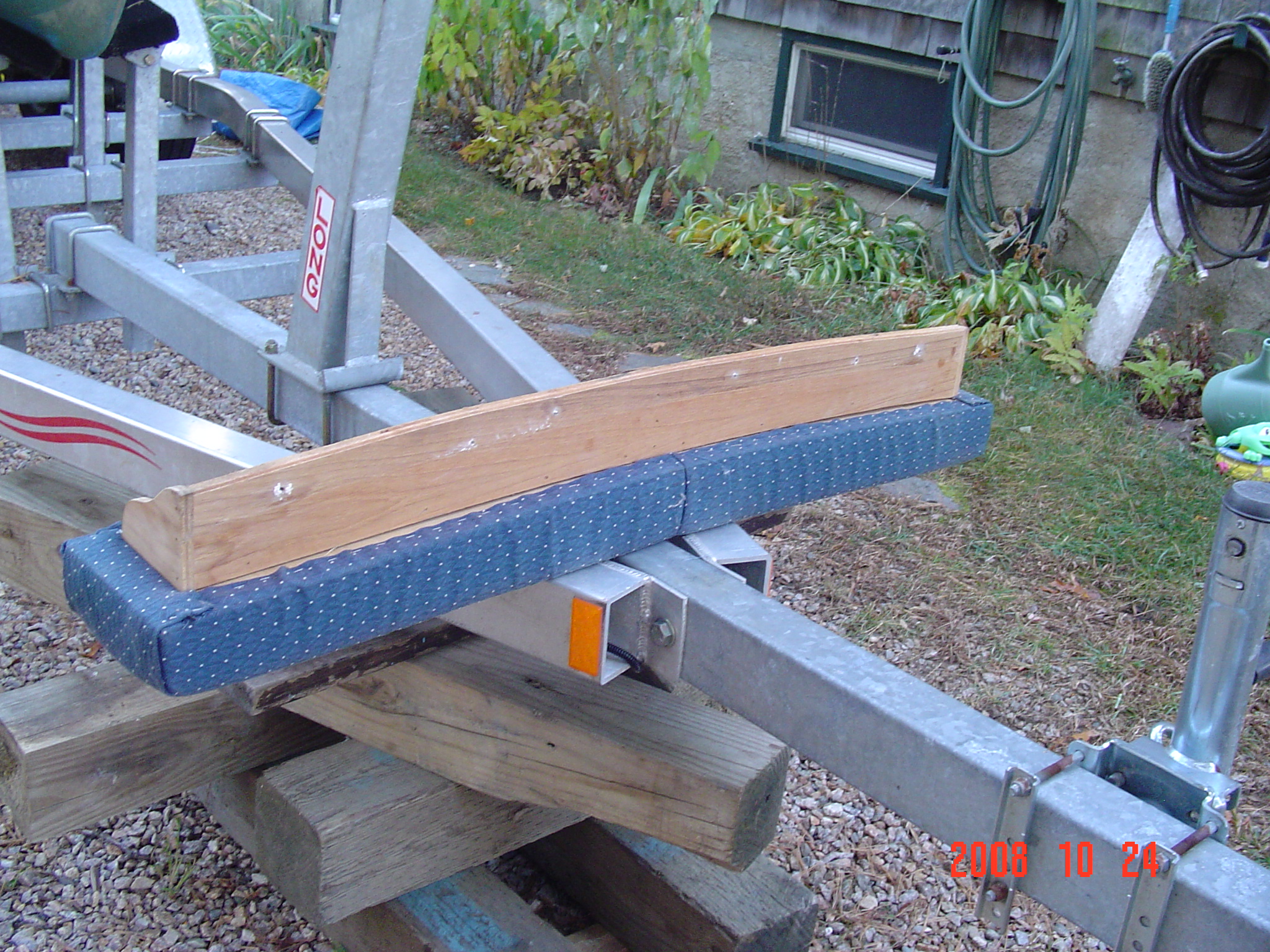

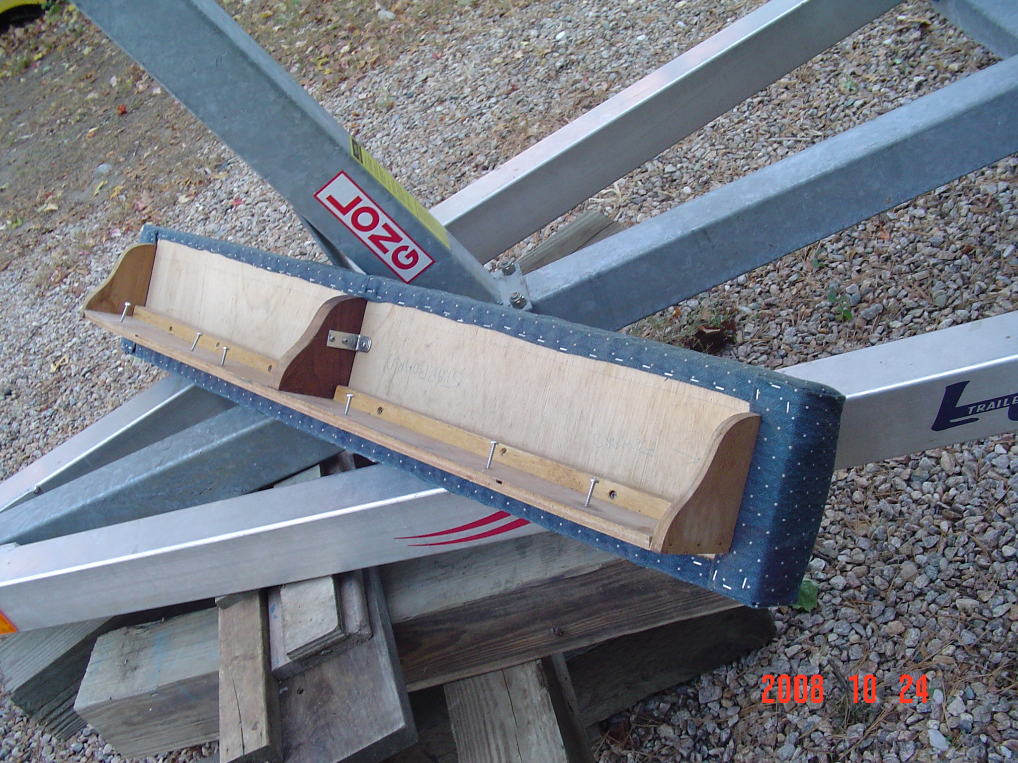

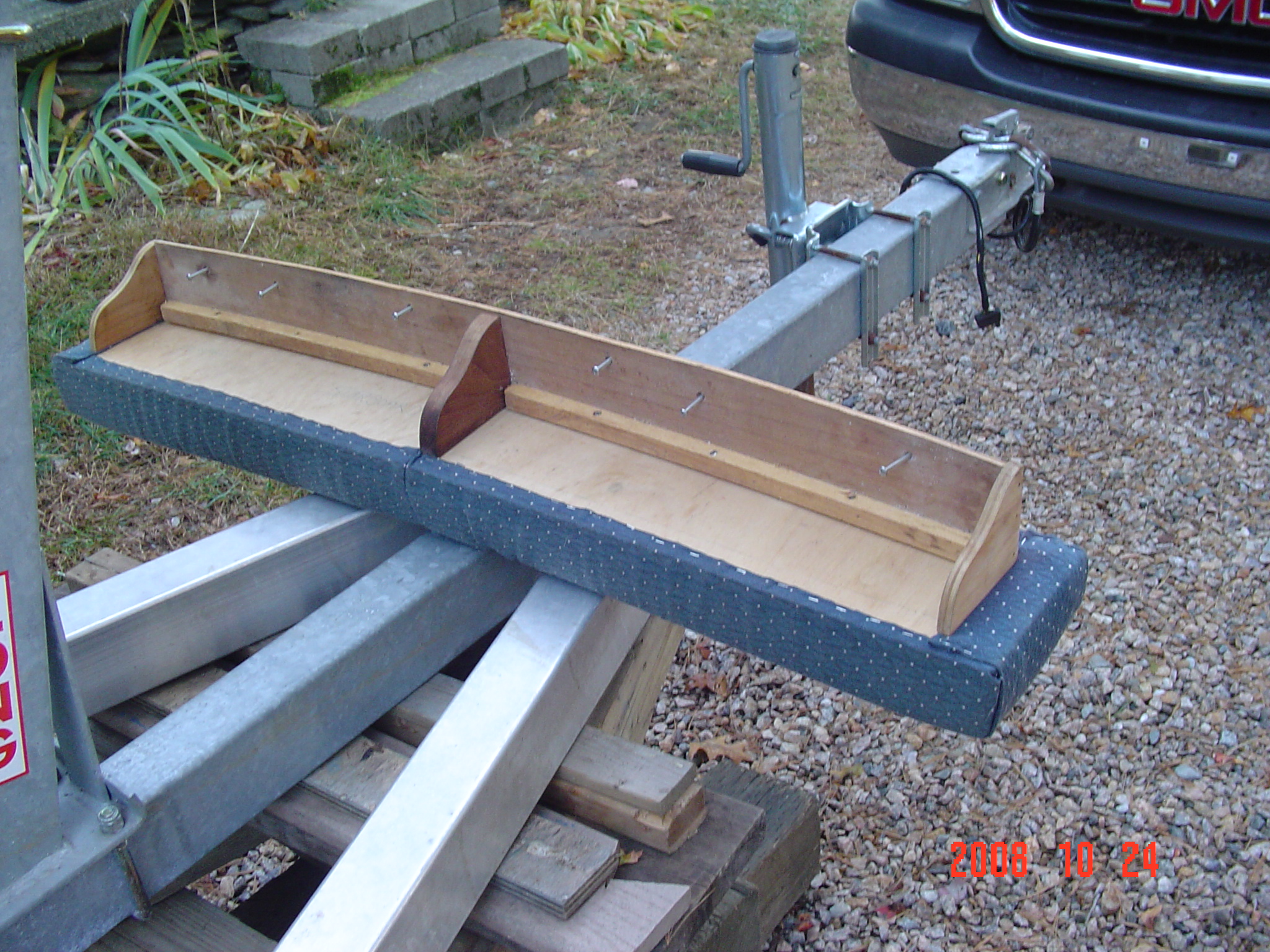

This is the bolster from my 86 O'Day 222. If you can bolt the knees to the backboard and bolt it to the shelf in the cabin, it will be a lot stronger. Mine came attached with wood screws from the factory and I did have a few problems with them loosening up over the years, but I had no access to the area under the shelf to bolt it. If you have such access then by all means, bolt it. I hope that I was able to be of some help to you. Good luck with that.
Joe
