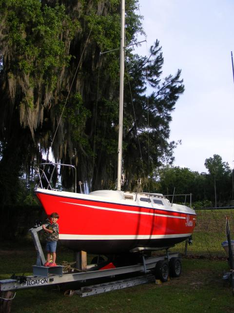

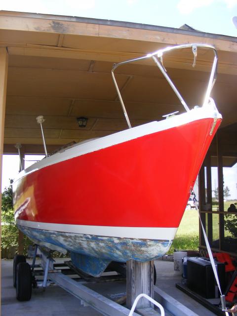

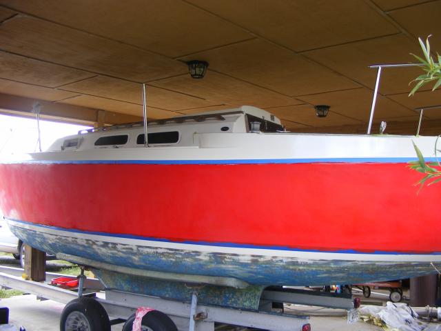

My trailer is a converted Float On power boat trailer. I launch from it. It has boat stand rigs that are welded on to a bracket and then mounted to the trailer. The wheel covers had to removed so that the tandem axles could be moved to balance the load. these are some older pictures to give you an idea. There is a board run between the boat stands.
The two older pictures of the boat being painted are before I built the tower for launching and retrieving the boat, I also built an extension on the front that slides out.
