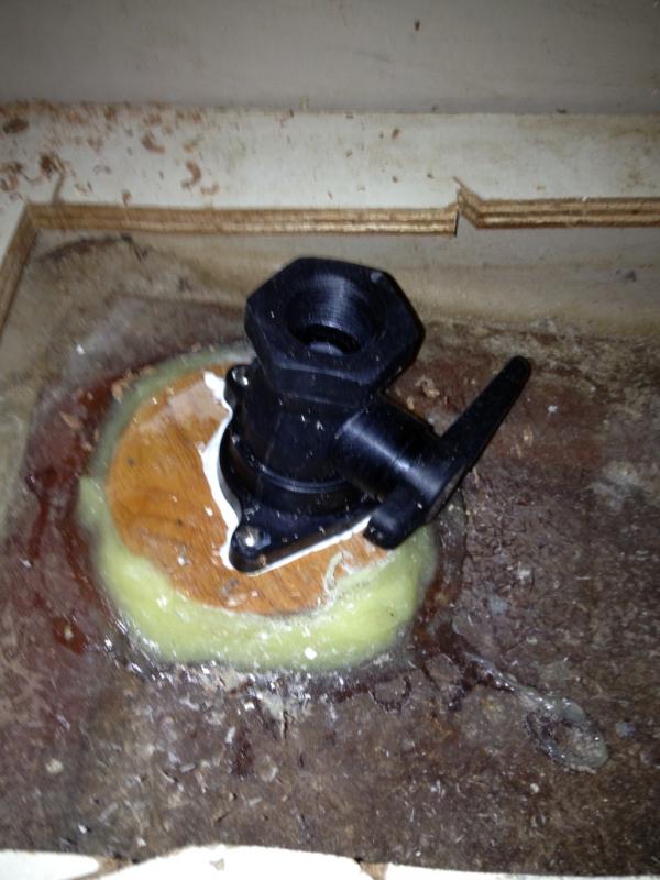

If you didn't thru bolt, is it just tightened and sealed with a sealant like 3M 4200 or 5200?
No, I used 2" s.s. screws through the three flange holes and into the backing plate I made. If u look carefully at the photo you can see. You can also see that I was off center a "little" bit. Almost too much!
Ward H
Nov 7, 2011
3,788
Thanks. Your photos helped to figure it out. I think I may go with the Marelon seacock and thru hull like you did. I like not drilling screw holes through the hull.
