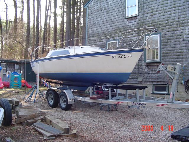

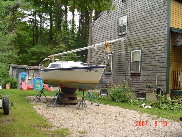

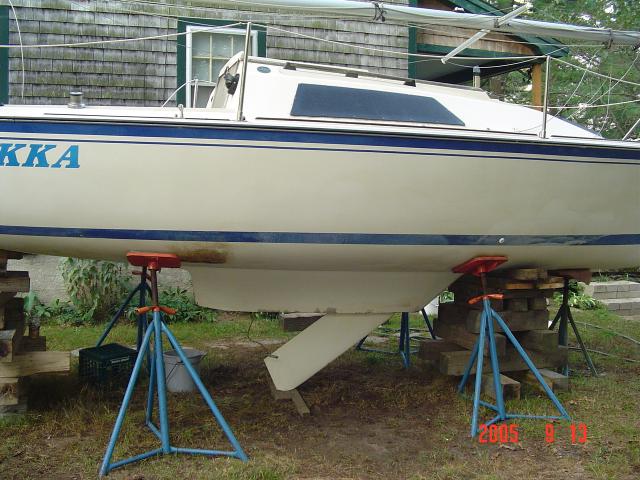

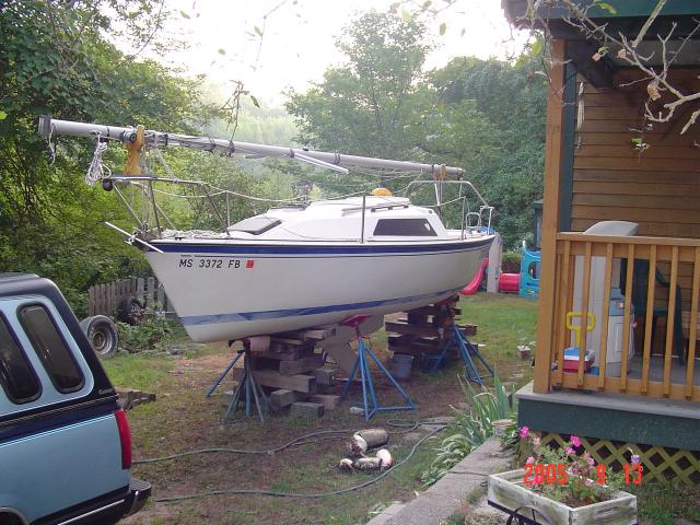

I have always been able to raise my O'Day 222 with my sailboat stands. Of course, boat stands aren't supposed to be used to raise a sailboat, but I have always taken extra precautions when doing this by shoring up under the stern and the bow portion of the hull with blocked up 6X6s. I also have the keel shored up to within a couple of inches. With that said; I once raised the stern of my friend's O'Day 26 with four of my boat stands. We were trying to move the trailer over a couple of inches because the boat was on a little off center on the keel board and the tide had gone down too low to back down the ramp again. I raised the bow of his boat with a hydraulic jack from the ground, and we were able to slide the trailer a little, to center the boat. The jacks pads under the stern were causing a slight oil can effect on the hull. If the jack pads and wood blocking are placed under the stern in an area of solid reinforcement such as a rear bulkhead, I think that you may be able to support the hull with the wood blocking in front of and in back of the keel, with the four boat stands holding the boat from tipping over. I don't have to remind you that this can be dangerous if certain precautions aren't taken. I plan on taking my boat off the trailer next week and putting it on stands so that I can paint the bottom in the spring. Two years ago I raised the hull and removed the centerboard to check the pivot pin and paint the inside slot. I thought about trying to support the boat with blocking under the front and rear portions of the keel, but decided against this idea. Having the blocking under the hull is a whole lot safer, I think. I've been taking my boat on and off my trailer since I bought it new in 1986. It was easier back then with the roller trailer. It takes more time to do with a flat bunk trailer. I use landscape wood blocks and power company cross arms of about 3 to 4 feet long. I also made wooden wedges out of cross arm blocks by cutting the block on a diagonal. These come in real handy for taking up small gaps. Pieces of rug are used in between the hull and blocks or jack pads. Plenty of blocks are required to take every precaution to insure that nothing goes wrong. As I pointed out, working with weights such as these can be dangerous and you're better off having someone with you who knows rigging or is familiar with it, such as a power company lineman or a rigger.

When I take my boat off the trailer, I set the boat's keel on the blocks as soon as possible. The whole weight of my boat is on that keel sitting on blocks of wood which are criss crossed for stability. The stands only keep the boat from tipping over sideways. Two stands can be taken out from under the boat at any time, and moved to anywhere I want to put them. The boat won't tip forward unless someone is on the boat and walks to the bow. Otherwise, as long as the boat is sitting on it's keel and the boat is not leaning sideways, it's safe. I am able to raise my boat with my four sailboat stands spaced about 6' apart, so that the keel is off the blocks. I wouldn't try doing this on an O'Day 25 because of the weight involved, but if you put your blocks under the hull in the stern and also block up just forward of the keel, I believe that four sailboat stands set up close together in the stern will raise the stern of your boat. A good hydraulic jack under the bow of the boat will raise the bow, but it should be done all at the same time if possible. As you raise the boat, you keep shoring up the wood blocks to keep them close to the hull. At no time will you be under the boat near the keel jacking it up. Don't do anything that you're not comfortable with George. Find out what it would cost to have it lifted. Perhaps the yard can set it up so that you can take your time and do what you need to do. Bite the bullet, so to speak, for your own piece of mind. I've been taking my boats off the trailers since the mid 1970s and I've done it so often that it's become "Old Hat" for me. So I understand your concern because for one thing, you've never done it before, and for another, your boat is a heck of a lot heavier than mine. Only you can make the call George. You're not chicken, you're cautious, and you should be. One wrong move could ruin your whole day.
