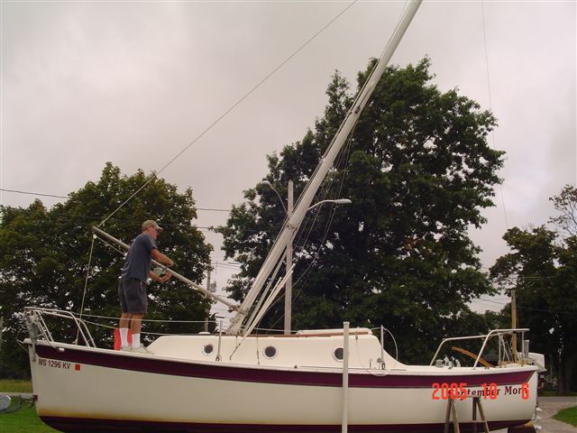

Gary,
A crutch to hold the mast can also be made of wood and attached to your stern rail. Here's one that my friend Wayne built for his Seaward 22. He has a small roller in it that allows him to roll the mast forward or aft.
Joe
