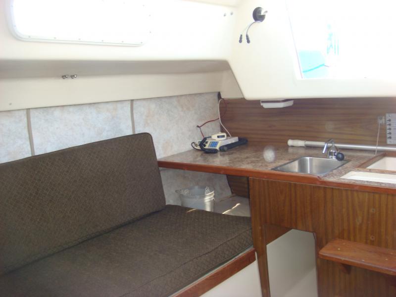

Liner for interior of boat
Thanks I am very much interested in how it worked out!
What material did you use and how did you attach to the hull? It looks just wonderful!!! Did you bleach the teak?
Thanks so much for sharing!

I replaced the interior of my O'Day 25. It was originally foam backed fabric glued onto the hull. I tore the fabric off and used a Dremel Multi Max to shear the foam off of the inside of the hull. Works real slick, just remember to use a little petroleum jelly on the serrations of the blade to minimize glue build up on the blade. I then glued 24" strips of Mannington vinyl flooring on to the inside of the hull. First I tried a 12 foot piece of vinyl. That ended in disaster as the curves of the hull and the horizontal wood stringer glassed into the hull were too much to form around. The glue I used was HH-66 from my local marine supply store. It comes in square gallon cans and is a lot like model airplane glue. I used floor cap/strip between pieces. I used a plastic roller from top to bottom, being very careful around the horizontal wood stringer. I trimmed the slot away from the back of the cap where it went around the horizontal stringer and to really secure it to the stringer I used #6 screws with dimple washers, 2 per cap.
