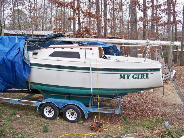

A lot depends on the design of the trailer. On my 26 which is essentially just an updated 25 I needed close to 12 feet with the mast resting on the rails.
It would be almost a foot lower if I fitted the pad post more precisely for the boat. My trailer was modified from a 27 boat trailer with a 36 inch draft. Since the trailer can be used for more than one boat, I leave it as is.
Then again my trailer rest lower than usual on its axles. So while it varies with trailer involved, I would suggest better than 10 foot to hide it. Maybe better than 11 foot.
