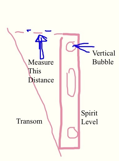

At the ends of your spirit level are the "vertical" bubbles. In the middle is the bubble for levelling horizontally. You're interested in the vertical one.
Dead vertical means the "vertical" bubble is in the middle of its tube.
Crude drawing follows:
Thanks a million. I thought it was something like that, using with the bubble at the end of the spirit level to find dead vertical. And thanks for the high-tech diagram.

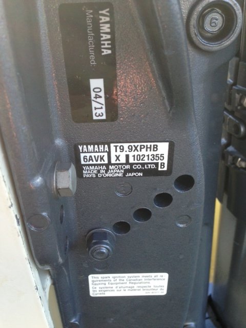

Just to cover all bases, have you checked if the OB has a trim adjustment? I have only used three outboards but they all had a trim adjustment. It was a series of holes with a bolt through one set. You pull the bolt out and can set the trim/tilt, then put the bolt back in.
Here is a photo on a Yamaha OB. (photo is sideways)

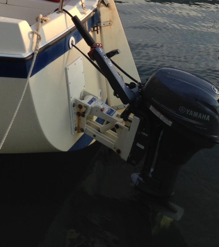

Here are some photos of my outboard and how it is mounted.
The first photo shows it tilted all the way down. The OB that was on the boat when I bought it was adjusted to make it vertical. I was lucky enough to get an OB with power tilt so I just adjust it to vertical each time I tilt it down. That is shown in the last photo, which is a bit blurry.

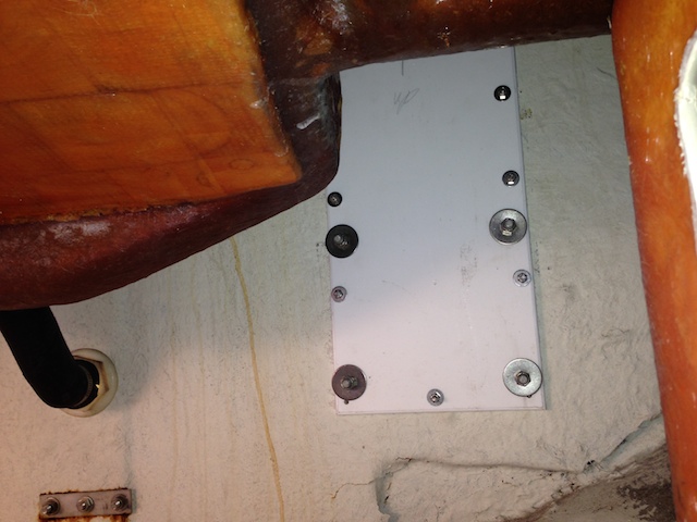

The second photo shows the inside backing plate. If I was doing it myself, I would have used 3/4 ply sealed with epoxy instead of the starboard as a backing plate but this works. So far there is no sign of the transom flexing, despite a run in with a dock last year which was hard enough to crack the cowling on the less than year old OB.

The bracket is an OMC which I understand is no longer made. I think it could have been mounted a few inches higher because when the bracket is raised the prop is still half in the water but that is not worth moving it now.
While some OBs may need the hump to move it out far enough to tilt back without hitting the transom, I think it is up to the bracket whether it is needed.
BTW, that's a Yamaha T9.9.
