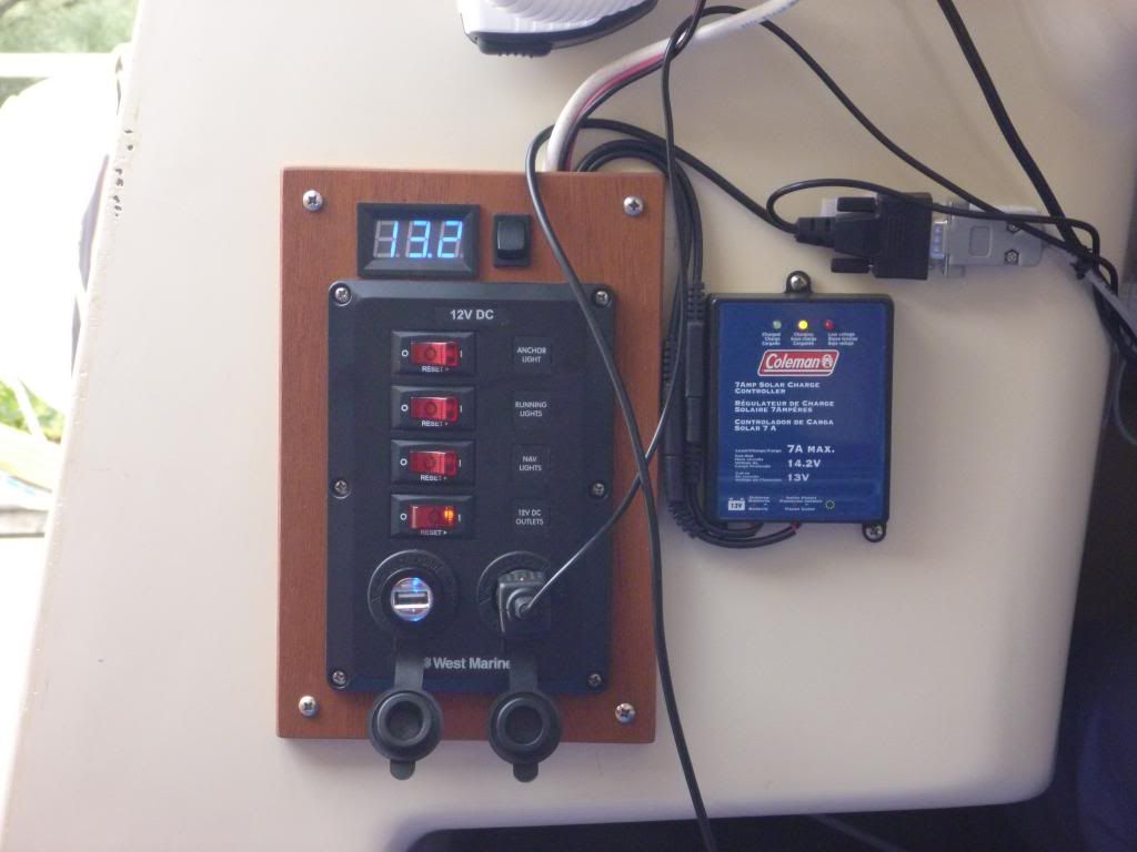

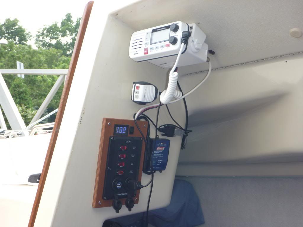

I built a new breaker panel and mounted it next to companionway, to starboard. It covers up the old instrument holes too.

Joe, I have that photo in my "ideas" folder but forgot where it came from. Nice panel. Is that set into the fiberglass bulkhead or is it a box mounted on the bulkhead?

Thanks for the kind words.
The box is about 2 inches deep, is surface-mounted, and is just deep enough for the switches I selected.
Getting the wires run up there was a pita, but I like being able to switch from the cockpit.

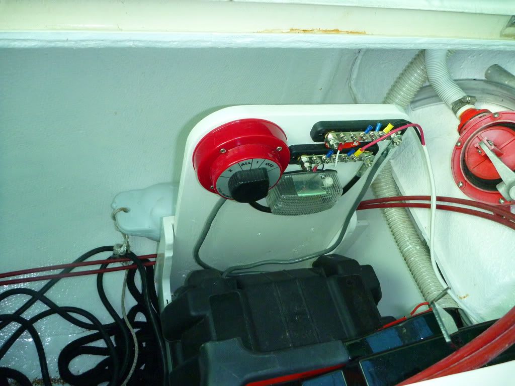

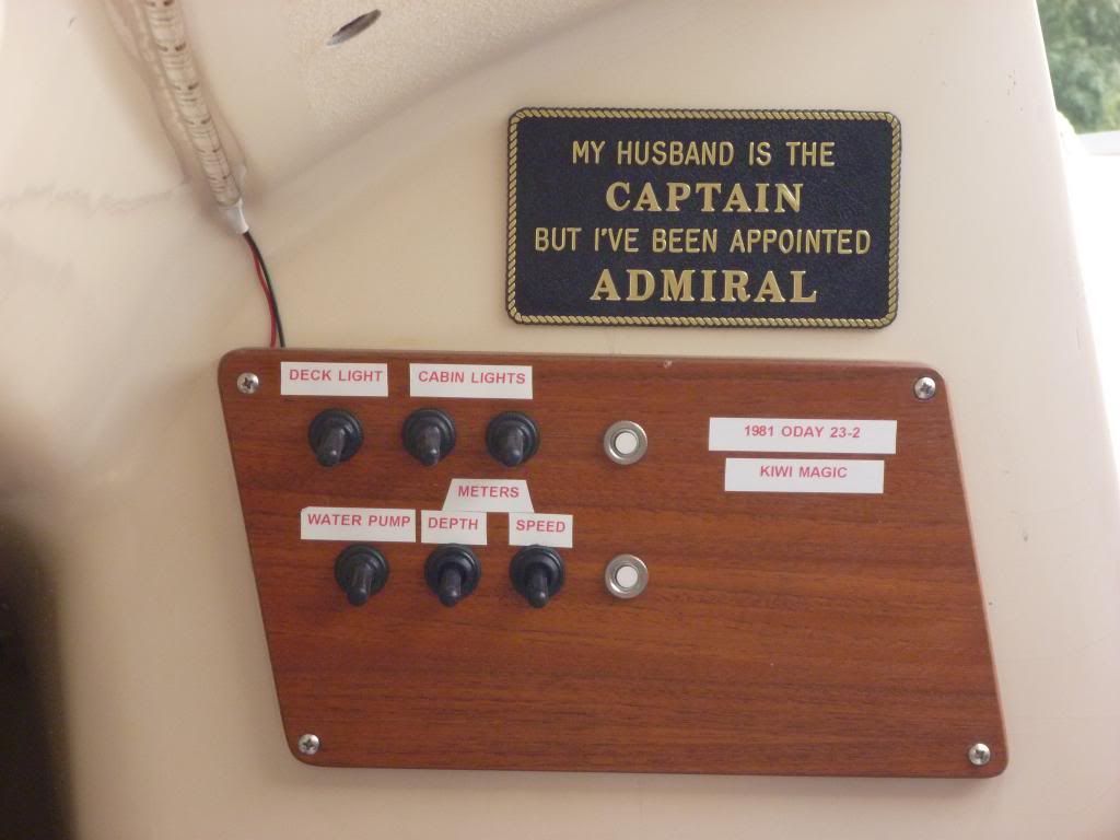

hi Ward
Here are the changes I made to my 23 which is probably similar to your 25.
1/2 marine plywood cut to cover existing opening.
Plywood battery box (previous owner) in the port lazerette modified for switch and power strips.
