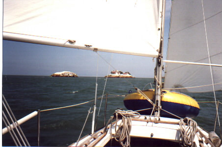

Guys I have both and am attaching a couple of photos. Ron, the peice you describe is how my vang is attached. Or I should say was attached as I found the ball broken of the short (6 inch) piece of cable a couple of weeks ago. I have no idea how it broke but it happened while on the mooring. I have no idea where to find a replacement but will be talking to Rudy soon about other supplies, I'll see if he has one. I don't have the gear to swag a new end on. I may have that gear soon. I also have a downhaul attached at the mast end of the boom. the photos show an eye attached with a block hanging the line runs from the base of the mast up to the block and back down to a cam cleat. I have no idea where this rig came from or who put it there. It was there when I bought the boat.

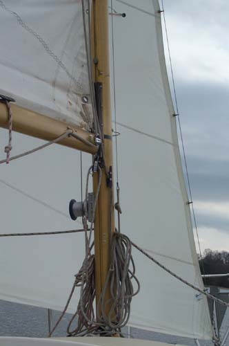

Another photo for reference...
The attached photo may help. I have the eye on the booms neck as well and the vang is shown. Let me know if you need picture sent with higher resolution or if this helped. Tor
