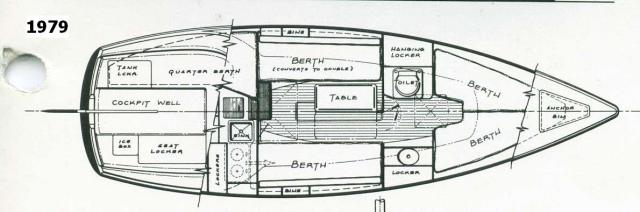

On the 25, the pull-out berth was on the port side only. That was standard starting with 1979 model (doesn't seem to even be an option prior to that). I think that the size of the settee on the port side would be the same for the entire production run of the 25, just that the 1979 and later would have a set of extra cushions to fill in the gap created when you slide the berth out to make it a double?

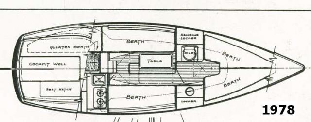

There was also a change in 1979 in the port quater berth cushion. On the 1978 25 this cushion was basically straight along both longitudinal edges. In 1979 the cushion, and the edge of the interior longitudinal side was flared out towards the forward end to make access to the quarter berth easier.
In the attached picture you can see the quarter berth of my 1978 O'Day 25. In later models the edge of the galley by the cooler was angled out and the cushion was cut wider to correspond.

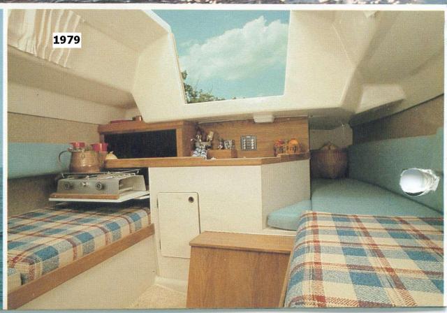

For comparison, here is a similar view from the 1979 Brochure, and a plan view also from the 1979 brochure. Also, the plan view from the 1978 Brochure (hard to see the change, but it does show). I think the aft end slide-out berth was supported by the "box" that replaced the companionway steps on the earlier models, and there was a wooden track to support the forward end (attached to the main bulkhead). It is visable in the pic of the main bulkhead that I posted below from a series of pics that I found somewhere.
