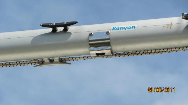

I would buy a bail that would fit the boom and bolt it with a 5/16" bolt. As for the mast attachment; almost anything can be used. If the bail doesn't fit, it can be bent and made to fit.
My boom has these special heavy duty eye straps that fit into a groove in the bottom of my boom. Some of them were just floating free when I bought the boat. I only needed to figure out where to place them on the boom and then I had to rivet them in place.

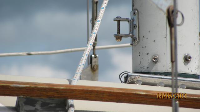

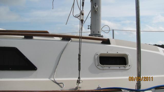

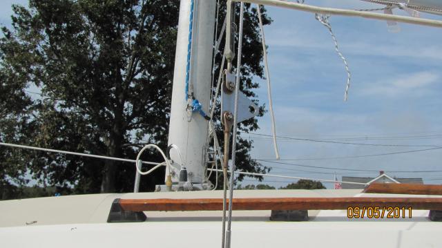

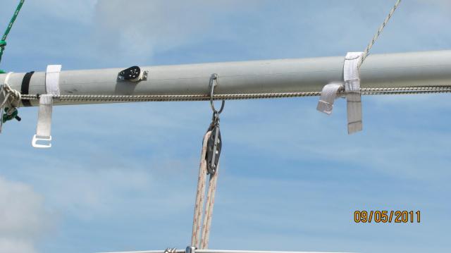

I was at the club today and had my camera with me so I took some pics of Ray's O'Day 26 on the trailer.
He has one of those round ball type boom vang fittings for his vang, but he also has a U shaped type bail for his mainsheet attachment.
He has some kind of a funny looking attachment on his mast for the boom vang. I also took some pics of his mast raising/lowering triangular plates on his lower stays. The plates appear to be the same size as the one that I had on my backstay years ago for my mainsheet to the end on my boom. You could use almost anything for the boom vang including the small pad eye that Rich uses.

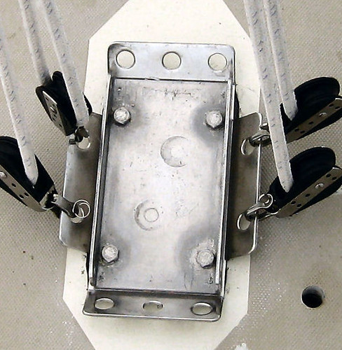

While you're at it, if it doesn't have one, install a organizer plate from Rigrite, not the one Rudy's selling.

That's where I got mine. My utility plate is exactly like the one pictured. It's made by Kenyon. I had to cut the back plate off mine because it was interfering with my mast raising. The top half of my Kenyon Tabernacle was hitting it and preventing my mast to pivot down low enough to sit in the mast crutch. I hated to cut it because I was using it for my boom vang connection. I've been tying a rope to the side plates and using that for my vang. Maybe I'll install something on my mast like Ray has on his mast.
