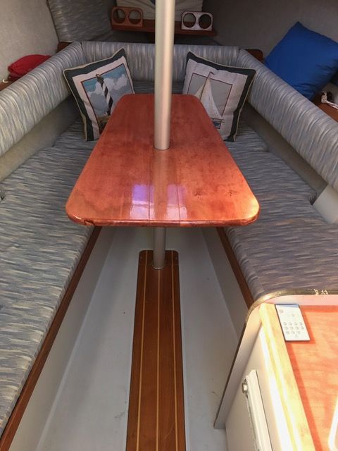

This is my 4th season with my 240. Great boat, handles well and the cabin layout was well thought out.
As far as what to look for I would say it's the same as any boat. Look for soft spots, check the bilge and make sure it's dry. Check the keel joint, although I have never heard of a problem with the 240's keel joint. That's more problematic with the 302 and 320. I would also check for leaking chain plates, stanchion bases and cleats. Pretty easy to tell due to the fabric liner. Leaks leave stain marks over time. You can basically expect leaks in one or all of those areas. Nothing that butyl tape can't fix. As long as the inner core isn't rotted.
Mine is leak free but that's because I re bedded those pesky areas.
I went from an O'day 22 to the 240. The difference in cabin space is very noticeable.
