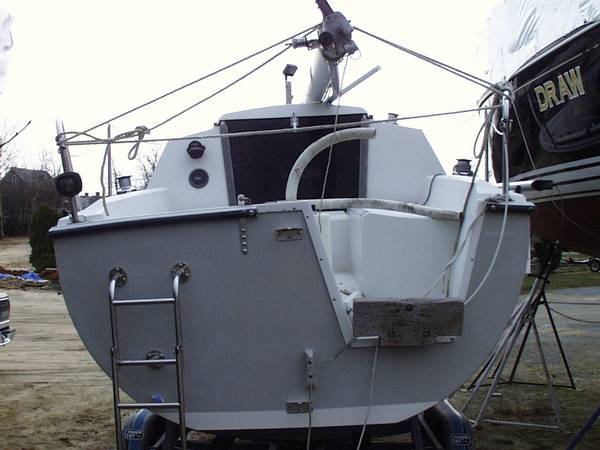

Boat is "home" working on cleaning her up and provisioning for 2025 season. Mount is fixed.

Measure from the mount to the bottom of the boat. Then, compare it to the outboard at a local shop. Ideally, you want the prop to sit in the water. at least 10-12 inches. You do not want the prop to pop out of the water for small waves.

With a Displacement hull sailboat, when under power the water will ride up to meet the bottom of the transom, so that is not a factor except at very slow, idle speeds, and even then, it may only be a problem if you have someone up at the bow which will slightly lift the stern up. The O'DAY 240 has a fixed-height outboard mount, located starboard-side, that would be a good walk-thru if the outboard were not there. A long-shaft (20") was recommended by O'DAY, a X-Long-shaft (25") is not too long, although I would think that 99% of the time, the 20" shaft will be OK.
