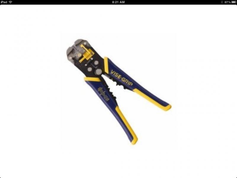

2. Wire crimper and stripper, when i discovered these they changed my life! haha

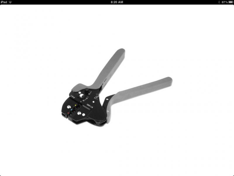

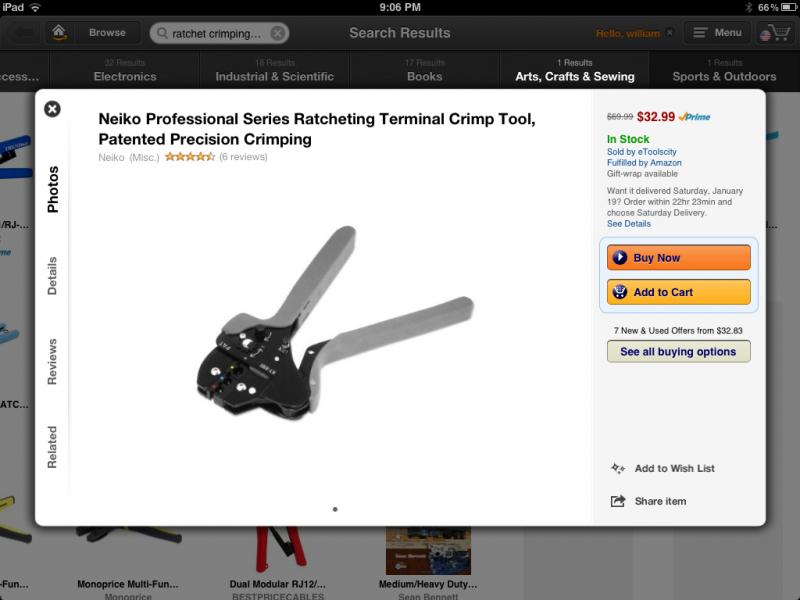

What crimpers did you buy?
Ward I am pretty sure it was an earlier version of this one. Search "ratchet crimped". I ordered mine off amazon.com the stripper is by the same company. Adequate is how I would describe the quality.
