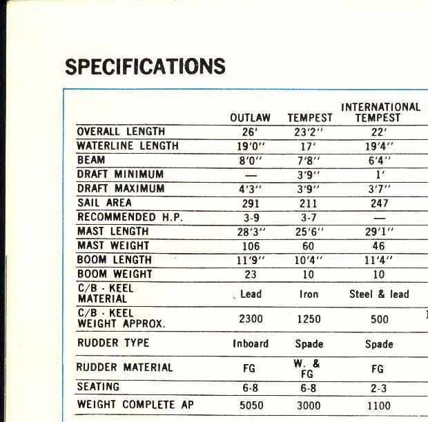

What years did they make the Tempest 23. I have a 73 23 O'Day and need a new mainsail but am not sure if it is a Tempest or just a 23. Help!

It looks like the sails won't inter-change. They are quite different.

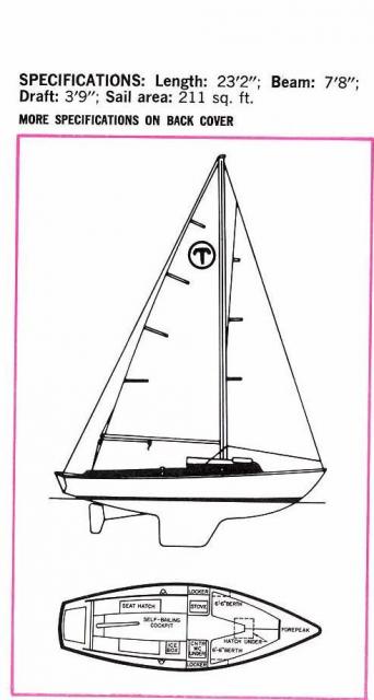

Tempest (NOT International TEMPEST, that was a racing boat) was built from about 1965-1970. The O'DAY 23 (like yours) was built from 1971-74. There was also a newer O'DAY 23 built from 1977-85. The TEMPEST was a Philip Rhodes design with a large cockpit and small cabin (2-berths), cast-iron fixed keel with an inboard rudder.
