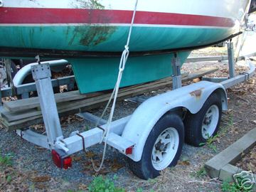

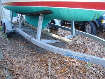

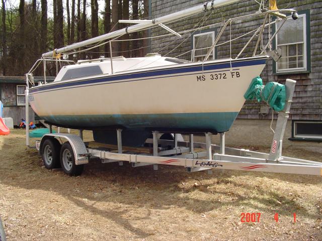

I'd be concerned that the O'DAY 23 weighs more than the Catalina 22. I have attached 3 pictures of an O'DAY 23 sitting on a trailer (I assume you are looking at a 1977-85 model?). This should give at least an approximation of how far the fin sticks down below the "freebody draft" of the boat (Freebody draft is the yacht-designer term for the draft of the hull alone on a keel vessel).
