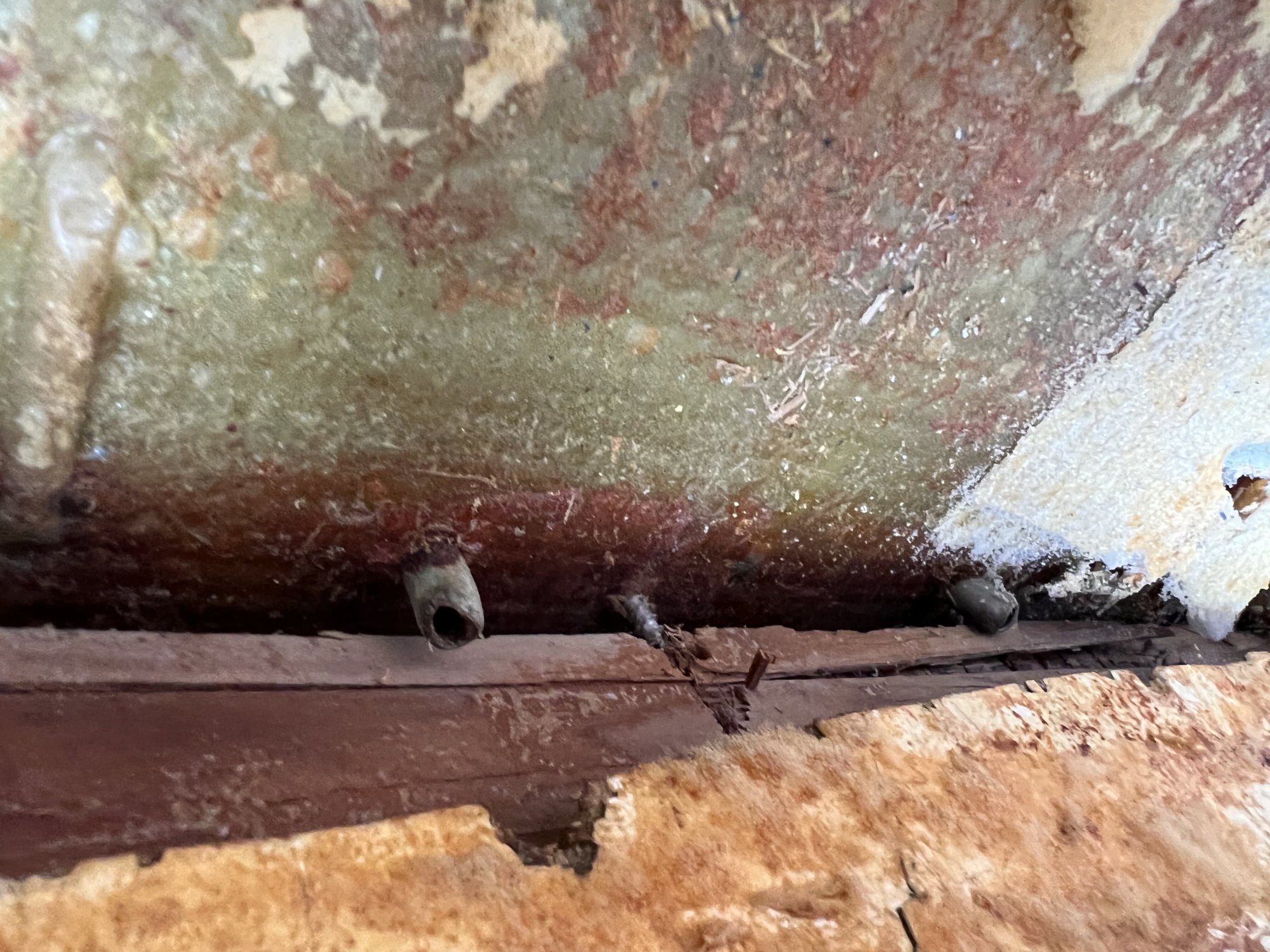

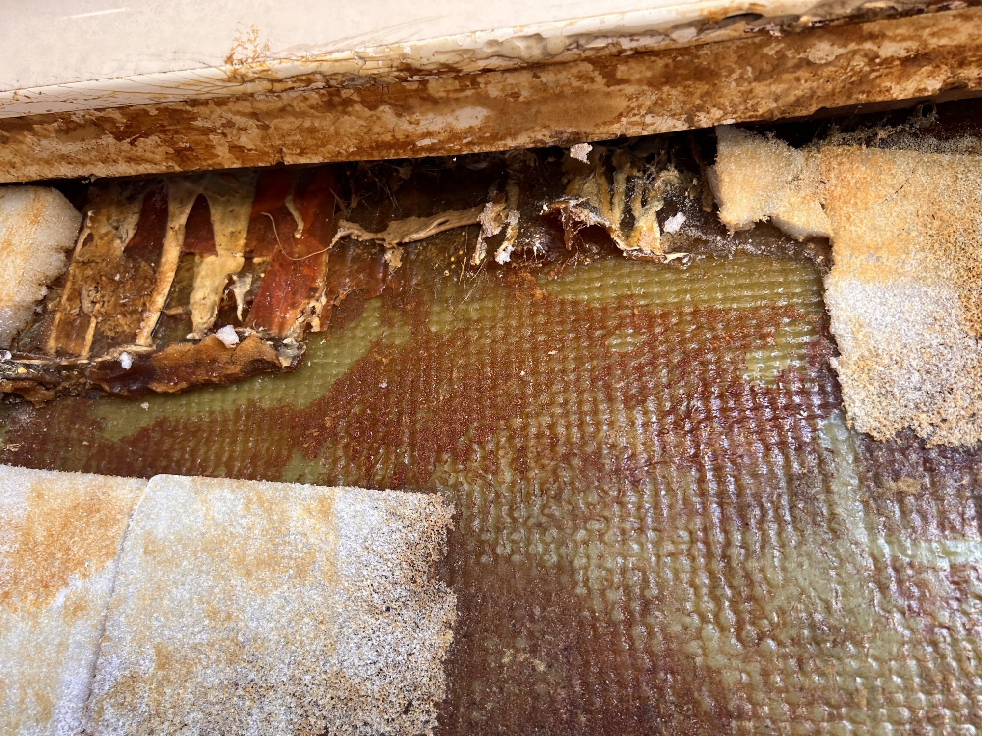

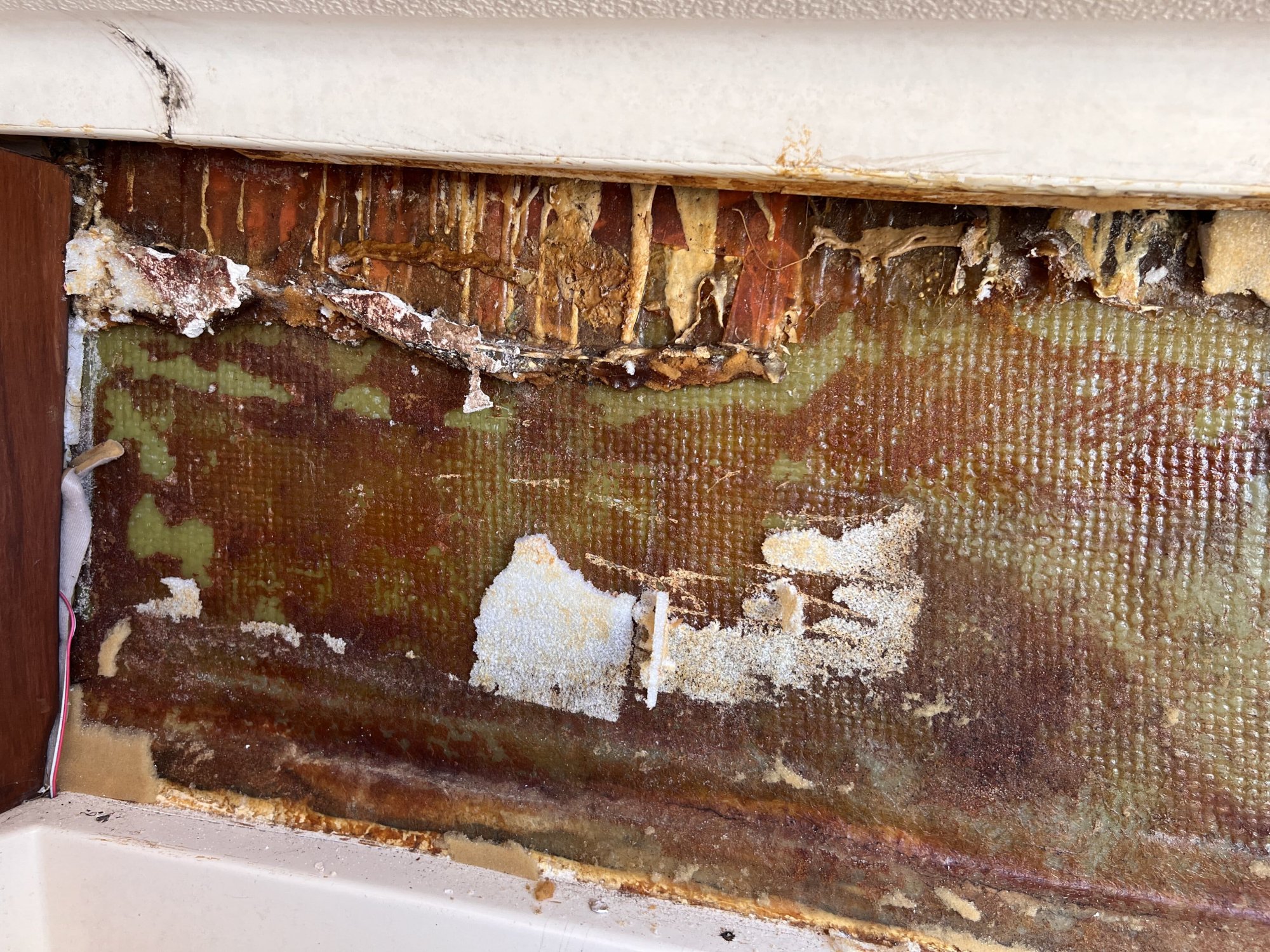

I decided not to cut hull liner because was able ti access all places that would like to paint lol. But I found smth weird on hull on starboard side. See photos.
Also above this weird thing on hull deck joint I see kind of plywood... any ideas what is it for? I do not see any damage on hull or deck outside....

A brush for cleaning off your Weber grill sould work just fine . My guess is what you are seeing came from a previous owner and definitely not from the factory. I would carefully try a heat gun and a scraper . The operative word is "carefully " . Just enough heat to soften whatever the white sealant is .

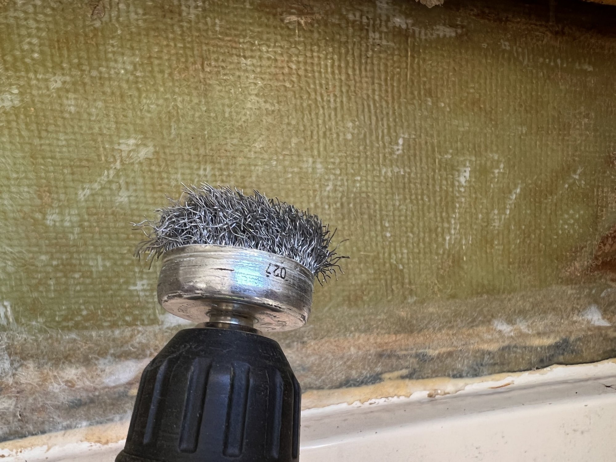

Grill brush work fine, but in some places I'm using scraper first. Tomorrow planning to try drill brush, just to compare.

I've found the easiest way to remove old adhesive from the fiberglass without causing damage is a fine wire wheel on a drill. A coarse wheel caused too much damage for my preference, but a quick final pass with the course wheel keyed the surface nicely for epoxy filler. Note "easiest", not "easy", it's still a messy pain. Gives the shop vac a workout, also PPE is important.

Wire brush on a drill plus wire wheel for specific places works great!
