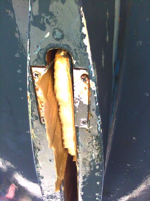

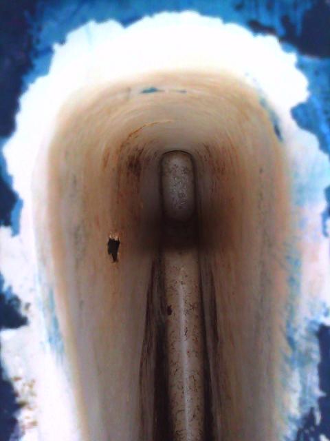

Can't remember where we were talking about replacing the CB, but I had my 222 hauled out today and had a look down there. Was able to take out all but one screw (head broke off it) and got the old CB remnants out. The plates, wedges, and pin were all good, thankfully. We will drill a new hole next to seized screw remnant, through the plate, etc, so that should be good to go.
Also noticed that I actually have no block/pulley for the CB pendant...I don't even see a place where it would go. No wonder the CB pendant is already fraying a bit...bummer. Also, it looks like there is some damage to the keel where the clevis pin for the shackle hits the inside of the keel. Should I try to repair/cover this? It's lead under the paint, etc. Check out the pics:

Michelle,
Is there any way that you can use an EZ-Out to remove the broken bolt, or drill right through the old bolt. The O'Day factory may have embedded a regular stainless steel nut into the lead and there might not be enough nut to drill though next to the broken bolt.

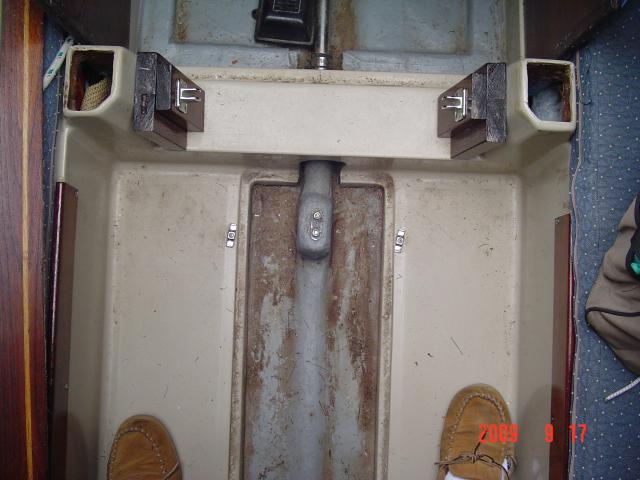

So what your telling me is, there is no recess area with a single sheave up inside the keel slot, similar to the way my keel slot is set up? How about inside the cabin near the step? Is there a hump where the pendant line pipe enters with a small metal strap on top for the block?
In my first picture it is pretty hard to see, but there is a square slot up in the centerboard slot where the sheave is located. If your pendant line pipe is similar to mine, you really need to have that sheave in there. When they first started building the older O'Day 22s with keel/centerboards, I think that they had the pipe going straight down from the cockpit companionway and had no need for the sheave. Then, I think when they first came out with the O'Day 222s, they moved the pipe back and added the sheave. This gave them room to put a cooler behind that Teak step in the cabin.
I hope that you're able to correct these problems. If something else comes up let me know. I have pics up the ying yang and I'm always willing to share them with anyone.
Joe

Michelle,
Now that I've taken a real closer look at one of your pictures, it looks to me that the square slot is there but the sheave is missing. I'm wondering if the previous owner removed it or whether the guy at the O'Day factory went on a coffee break that day and forgot to install it. I can almost make out the two filled screw holes in that little pocket where the sheave is suppose to go. There is supposed to be a small eye strap that holds the sheave up inside with bolts that go up through the hump. In the cabin, there should be a small flat plate where the bolts come through for the nuts and washers. Ed K., one of the members on this forum claims that he was able to remove his sheave and replace it on his O'Day 26. I would talk to Rudy about this and if you don't have the sheave, eye strap and small flat plate, I'd have him send it to you. I think that Ed was able to get it in there with a long screw driver I'm not sure. Maybe he'll chime in about this. Meanwhile, you should start a new thread on this forum and he'll find it and chime in.

Hi Joe,
Well, I hadn't thought of looking in the cabin...I wondered how they got the sheave in there. I agree it's way better than chafing the be-hooey out of the pendant.
On another note, I went to install the new CB...I opened the box and it's just a board, no drill holes, nothing. So I drove boat (no wind) halfway up the lake to get it lifted out, for no reason. I can't just slap a hole in it and put it in, the water will get in and freeze/burst like what happened with the first one. Someone just drilled a hole, exposing the core, and slapped it up in there. Anyway, I am going to call DR Monday to see what they say. Wish I had known it was a unfinished board, I would have planned differently. Oh well, right?
If I'm 'on my own' with this board, I will drill a hole bigger than what I need for the pin, epoxy a pvc bushing into it, and same for pendant shackle hole. Should be protected from water and good to go...just have to pay to lift again (ugh). Worry bout that in Spring, hehe.
