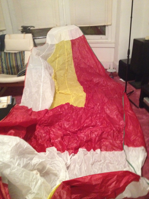

Thanks, Scaramouche, for your comments. I took a bit of a turn on my asym - the guy I bought the boat from had a cruising asym, and I didn't want to buy it at the time. Well, turns out he still had it; for practically pocket change, I now have a Neal Pryde "Spanker" asym, and an adjustable Forespar whisker pole. I've attached a pic of the spin. I wouldn't call it a particularly attractive spinnaker, but it has color, and it will be fun. The former owner bought new sails from Pryde, because that was the original sail supplier, so I know that this asym is sized properly for the boat, as opposed to the asym I got from a ComPac 19.
It also came with a turtle. Kewl. I pulled it out in the living room, and I found it had a tack line and sheets tied on to it. And they are lightweight floating polypropylene lines - you know, nice double braid ones, not crappy stiff single braid stuff barely suited to dock lines. So, score on that, don't need to buy new ones!
The sheet is tied on to the clew. I've decided I'll untie it, and retie it in the middle like it is now to make a loop, but attach it to the clew with a 3/16" Dyneema soft shackle that I'll make myself. They are so easy to do if you've got fids... I'm not thrilled about making a loop with an overhand knot like that, but... I dunno, maybe I could stitch a loop into the single sheet, and then whip the stitching tightly. Not sure if that's a good way to do this or not... I've got some snap shackles on order for the head and tack line. My thinking is I can run the sheets and tack line at the start of the day, then pull the turtle and sail up on deck, and then quickly attach the lines.
