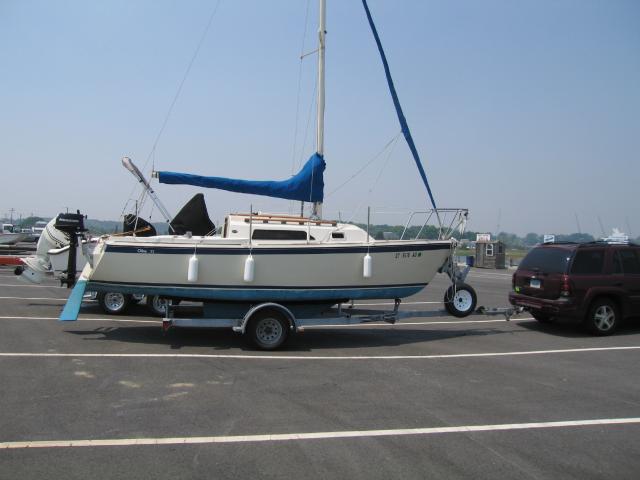

Congratulations Jack. When I got my 1983 O'Day in March it came with a single axle Load Rite with old dried out and cracked tires. I needed to haul my boat 246 miles to Cade Cod from western Connecticut and there was no way I was going with those tires. They were F78-14ST which was standard biased ply trailer tire back in the day. Trailer tires need a stronger side wall than passenger car tires because they are likely to get damaged hitting curbs and rocks, etc. You can still find F78-14ST but not easily. The equivalent trailer tires today are radial biased 6 ply 205-75R14. I paid $79 each installed at the local tires shop which was especially nice because the boat was still on the trailer. The radials tires have a side to side motion that can be a bit disconcerting when towing a high speeds. Once I got used to sway they handled very well and are noticeable quieter. I also wanted to add a spare tire mounted on the frame. I found the exact same 205-75R14 trailer tire mounted on a rim at the local Tractor Supply Co for $110 and the trailer mount fit was another $30.
http://www.tractorsupply.com/trailer-tires/205-75-14-trailer-tire-wheel-3014008
http://www.tractorsupply.com/traile...y-on-trailer-trade-spare-tire-carrier-1091290
My boat ‘Greta’ is pictured below ready to launch for the first time in May at Wellfleet Mass. I’m loving Greta and I’m sure you enjoy your 222. BTW I found Greta for sale on Craig’s List, how did you find yours?.
