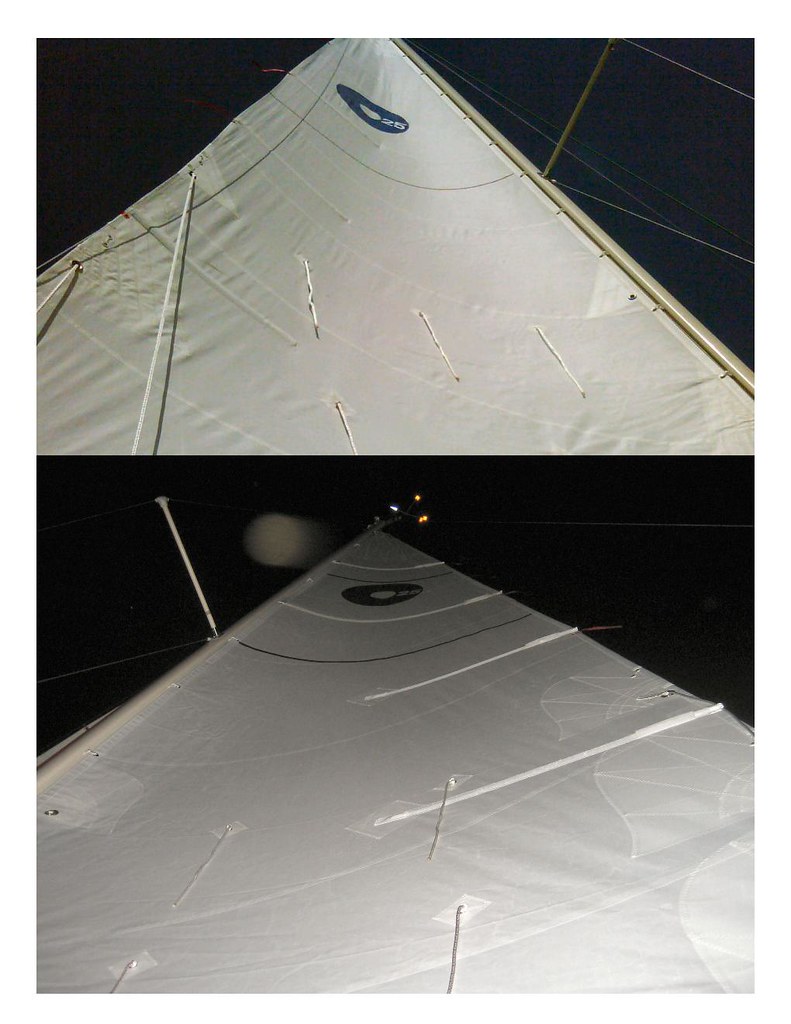

After rebuilding and upgrading my boat since buying her in the fall of '08. I sailed her all this summer and thought the main looked pretty good. I was sailing this past September in 12 to 15 kts, single reef, broad reach. Fell off to do a gibe and head back when I got hit with a sustained 30 kts. Before getting the mail under control the top 5 to 6 sail slides snapped off. They were old and should have been replaced (they looked okay). Anyhow, while replacing the slides I started thinking about getting a new main. Just enough time left to enjoy a little more of the season. In the fall sailmakers usually have discounts to have a little more work in the winter. I checked with the local Doyle Sail Loft. Just over $900 for a new sail. Top two battens full length, two sets of reef points, draft stripe and Oday logo. And they built it in two weeks.
Top- old main
Bottom- new main
Night and day.
The old sail had lost all of the filler in the weave and felt as soft as an old bed sheet. I didn't realize it was stretching causing too much draft and overpowering. Also the luft bolt rope had stiffened and wasn't stretching like it should.
If you can afford it go for the new main. Discounts are running out and usually the sailmaker will allow you a few months to pay it off.
Check out their websites. Call around and get some prices. There should be plenty of sail lofts around your area. They all want some business for the winter.
If you decide to send to sailcare forgo the cleaning because that would wash out any remaining filler.

Wow Rich, I didn't realize your before and after pics. It is night and day. Funny my main looks just like your before.
