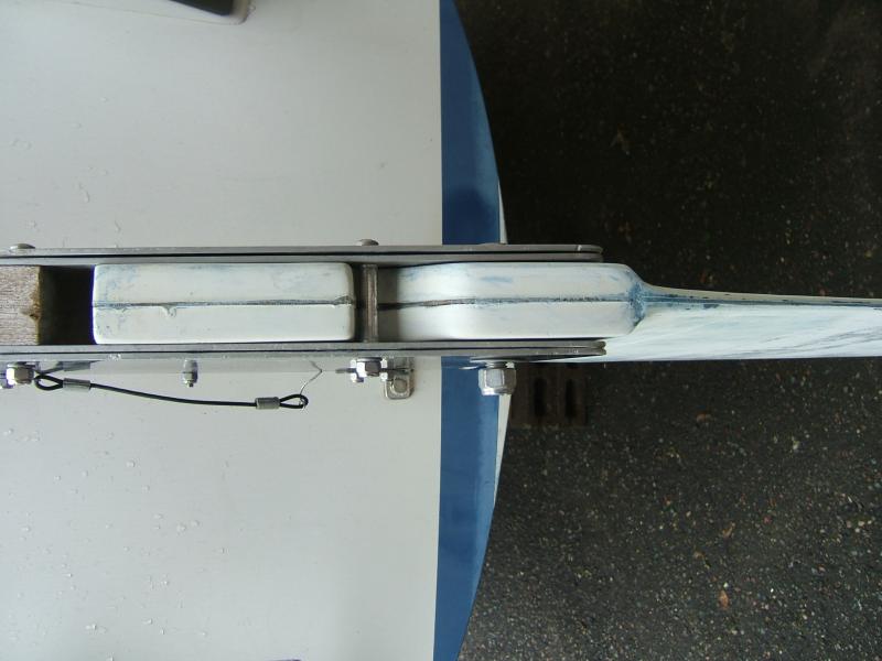

The previous owner ( I am the second owner) must have added the aluminum plate to the lower half of rudder head on my 1987 Oday 222. Other than the additional aluminum plate, my rudder and head assembly appear to be original. I am not at my boat , however would guess the added aluminum plate is about same thickness as existing rudder head aluminum- approximately 3/8 to 1/4 inch thick. Steering feels solid, with little slop.

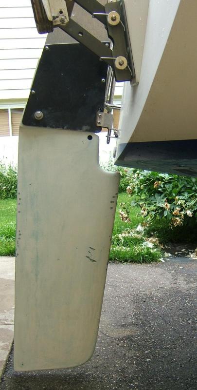

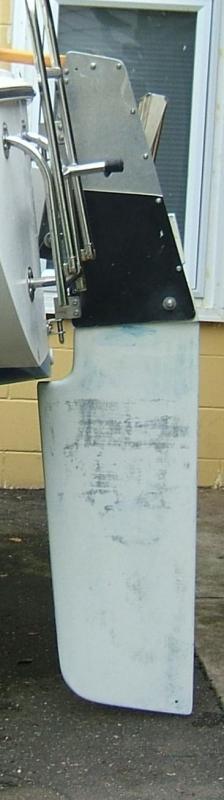

I remember talking to Rudy Nickerson at his shop about the rudder heads on some of the O'Day 222s being very thin. My rudder head is 1/4" Aluminum. I can tell that you have the original rudder blade by the seam where it was glued together. I'm wondering if Foss Foam Mfg also built the rudder heads as well as the blades. The rudders on these boats and even the larger O'Days were very inferior. It's a shame that O'Day couldn't have contracted with another rudder company. My original rudder blade broke shortly after my guarantee ran out and it cost me $160 for a new one at the factory. It wasn't too long after that, the other blade broke and O'Day had gone out of business by then.
The blade I have on my boat now was built by Jeff who was Rudy's business partner back then and it still as good as the day I bought it.
You could probably reinforce it like the one in the picture posted by Mich, or you could make a new rudder head out of 1/4" Aluminum or Stainless Steel. If you choose to do the latter, I would extend the rudder head about 1.5" higher than the transom so that you could go with a thicker tiller than the one that came with the boat. You may be able to accomplish the same result by dropping the pintails down to the next hole and boring two more holes for the pintails like I did to mine. Check out this link to my photo album for pictures.
http://forums.oday.sailboatowners.com/album.php?albumid=372&page=3
