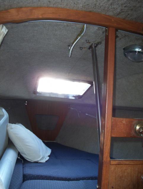

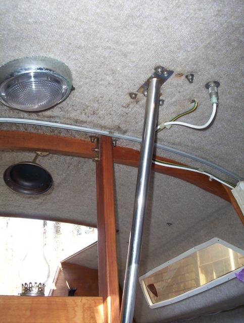

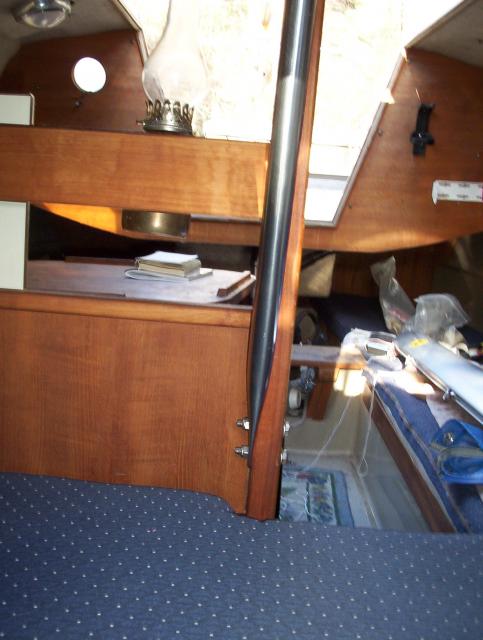

Could you take some pictures of it and post them here? Does your boat have a tension bar inside the cabin like mine?

My boat is a 1988 and has that brace. I am not at the boat and have no pictures, even if I did , I wouldn't know how to post them. Where the post sits on the floor, the fiberglass floor has sunken in, I can stick my finger between the floor and the botom of the bulkhead right beside the post. I would think there would have to be some kind of support under the floor to support the post. I would think it is built similar to other Odays, I was thinking of cutting an access hole just in front of the post, maybe I could get to and remove the old support( wood?) and replace it with something more durable. I just don't know how the floor or inner liner is supported.
