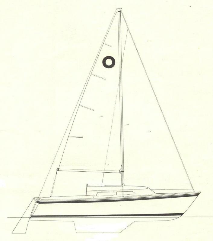

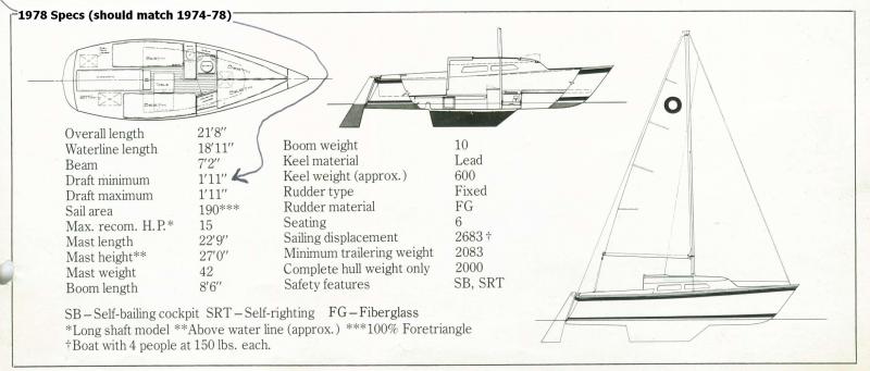

There were really only 3 versions of the 22, no real difference in the hulls, just the rig and the keel.
1972-78 Masthead Rig, shoal Keel (1'11" draft, 600# lead ballast)

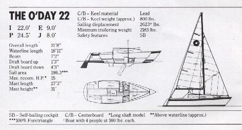

1979 Masthead Rig (same as 1972-78) and Keel/CB (1'3" Draft bd up, 4'3" bd dn, 700# lead ballast).

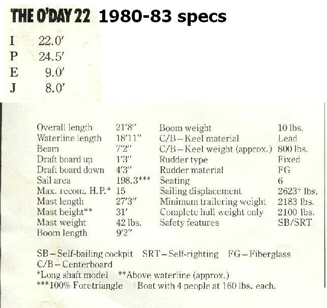

1980-83 Fractional Rig, Keel/CB (same draft as 1979, but now 800# lead ballast)
Masthead rig Dimensions:
Mast Length: 22'9" height above WL: 27'0" Sail Area: 190 sqft (main and working jib)
Fractional Rig Dimensions:
Mast Length: 27'3", Height above WL: 31'0". Sail Area: 198.3 sqft (Main and Working jib).

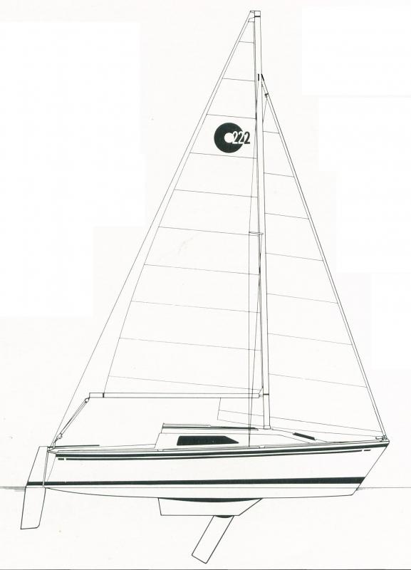

I think the various designations that you found are just different names for these same 3 models. 222 was a completely different, New design that replaced the 22 for the 1984-89 model years. The rig was totally different from the 22 as well.
