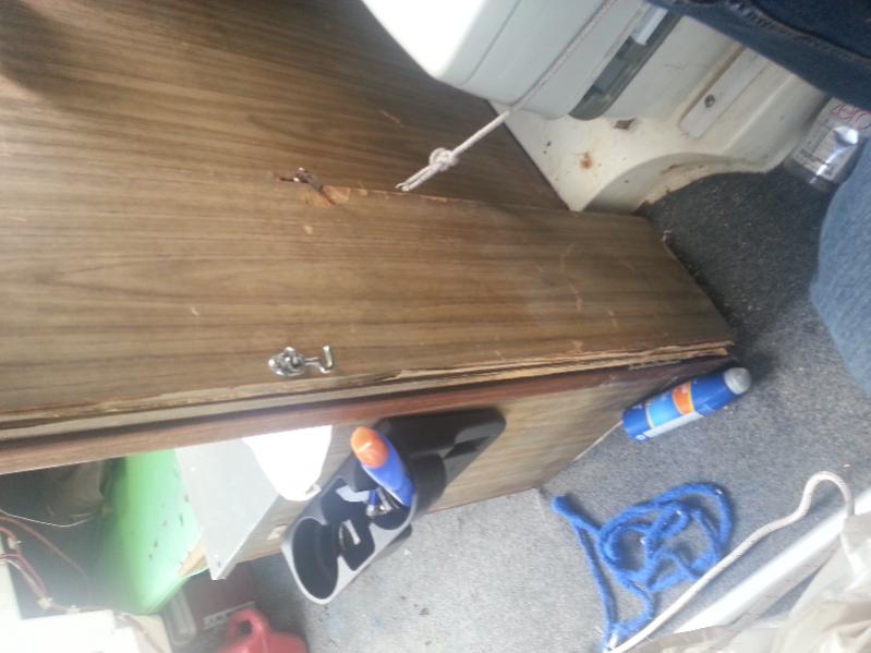

Mine (a '73) is a bi-fold door that swings in (toward the bow) and folds in half while open (if you can picture that). It is hinged on the center post. It's not in very good shape and I never use it - I don't even know if this is the original door or not. I can get some pics of it and post them tomorrow.

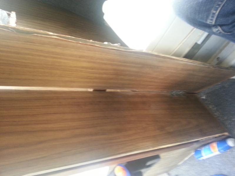

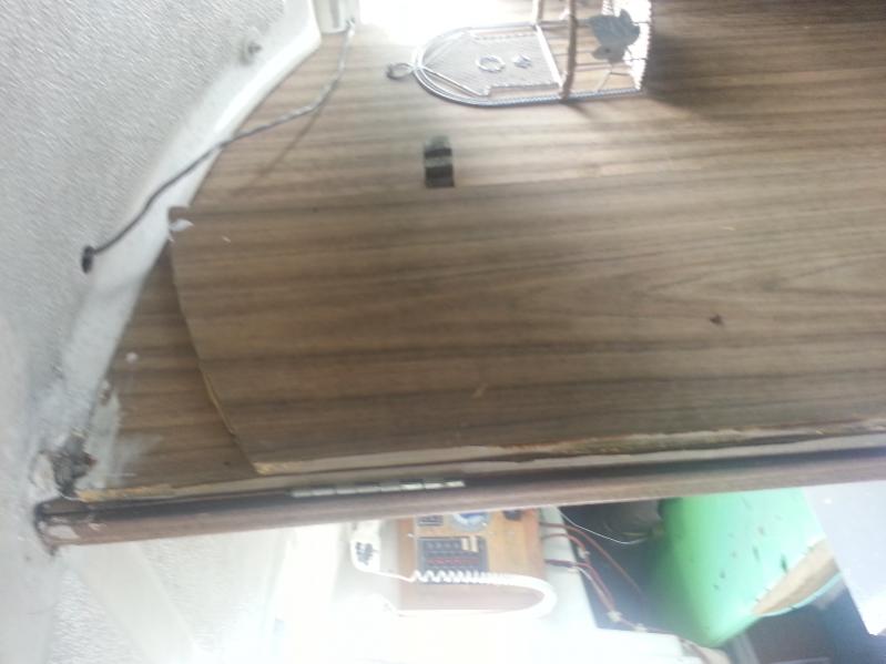

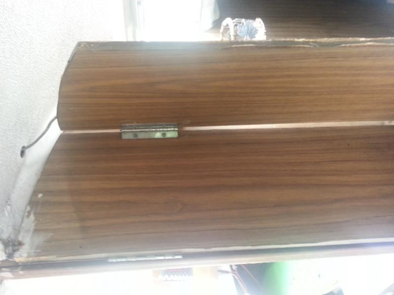

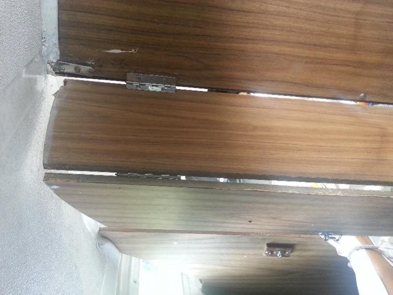

Here they are. I took these with my phone and could not get far enough away to fit the whoke door in a singke shot - so I just took a bunch of them.
I have more but I think that shows whats going on.
The door material is pretty thin. I'd say 1/4 inch ply with a veneer.

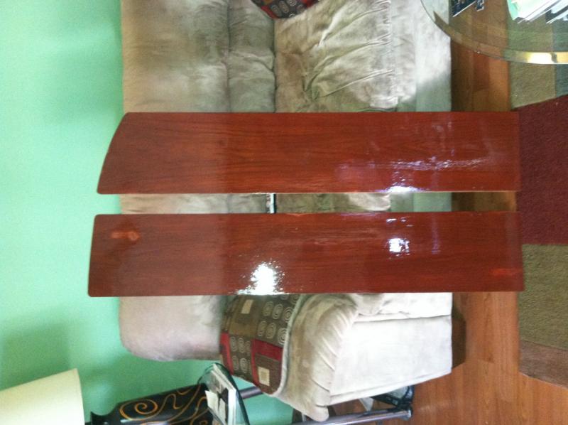

Ami342, I'm in the process of refinishing mine. The doors from my 1980, 22 footer are 8 5/8 wide.
Dec 27, 2012
587
Precision Precision 28 St Augustine
My doors were in decent shape so I stripped stained and varnished. You can see a few spots were I was a bit to aggressive and sanded below the thin veneer finish. No big deal, the doors will be behind the port bunk 99 percent of the time.
